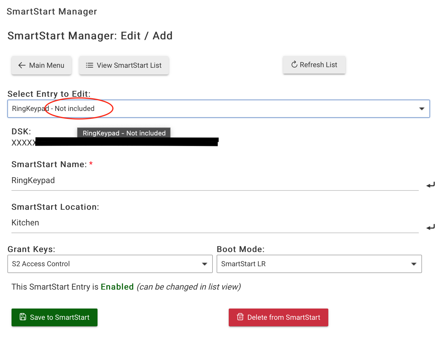

Pad currently won’t include or exclude when it’s in 3-flash green Tx/Rx mode. While SmartStart has worked previously, deleting the Smartstart entry and reentering it via QR code, recalls the previous DNI (0019) (like a ghost). Before this, when I removed and re-included it, the DNI incremented one integer starting with 0011 (and now ending with 0019). I’ve deleted the Hubitat app from my iPhone (and confirmed data removal) but SmartStart continues to show the pad as included on DNI 0019.
I’m seeking some troubleshooting hint on how SmartStart knows the pad is included, and if there is a way to reset this source database besides completely wiping my C-8 hub and starting over. Thanks.

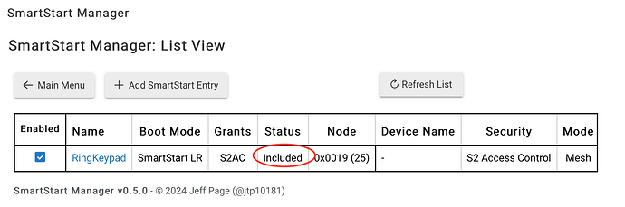

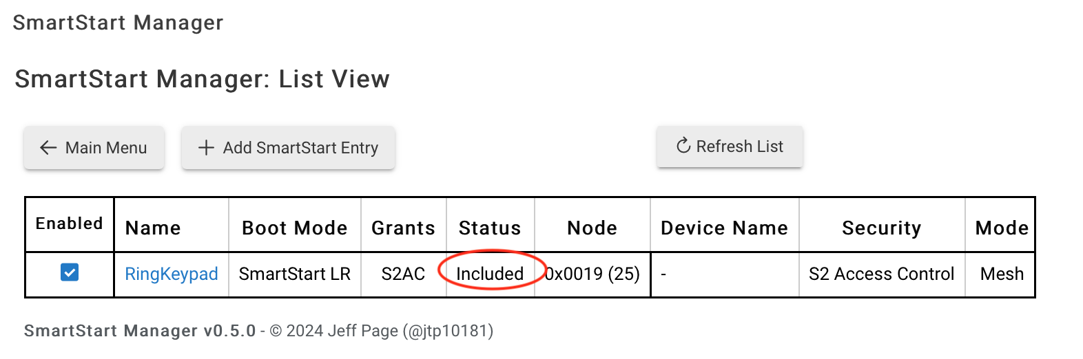

I discovered SmartStart Manager app, which is terrific for troubleshooting. Here's my conflict issue:
I threw in the towel. After a soft reset didn't clear it, I performed a full reset and started over. Conflict cleared and SmartStart Mgr app saved the day.
