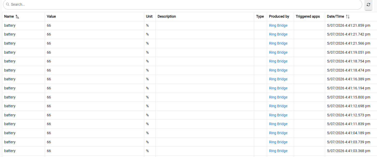

The other issue is States are duplicating which is spamming the logs with events, is there a way to have it setup to ignore the states if there's no change to the state so it doesn't show up unless there's a change?
Example of one of my lights, showing 66% battery 15x in 1 minute in the events as another example:
Seems like all of the devices are doing that which is causing a lot of Hub Load alerts due to how many events shows on the devices.

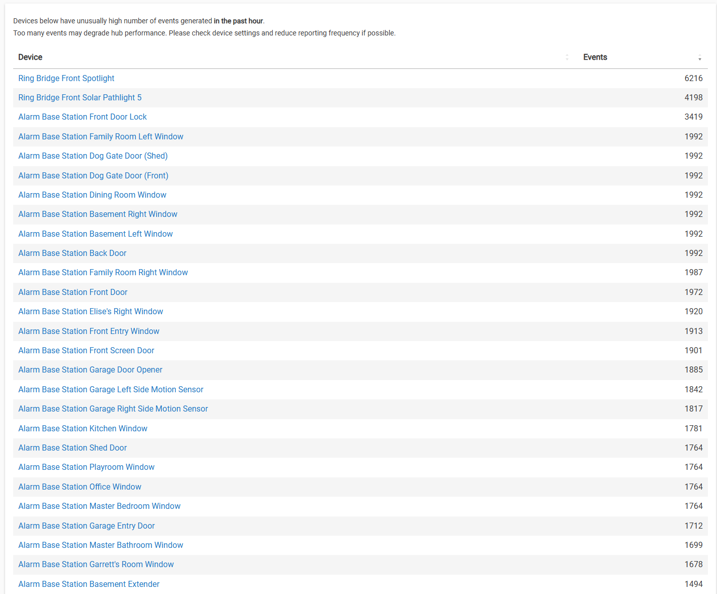

Debugging may also need to automatically disable on the devices after 30 minutes of the device being created, the number of debug messages that displays really spams the logs for the Lighting Bridge and Alarm Base Station.
Alarm Base Station for example getting Excessive Hub Load alerts:
Please do.. I can turn up backend logging to track down the remaining issues..
It's very chaty, this might be the bigger issue to tackle first:
I think just needs set up to filter duplicate events like it would with Z-Wave and Zigbee devices so if the state actually changes it'll display as an event (remove duplicates) and turn off debugging automatically after 30 minutes so logs don't fill up.

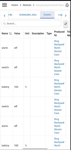

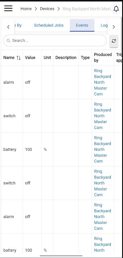

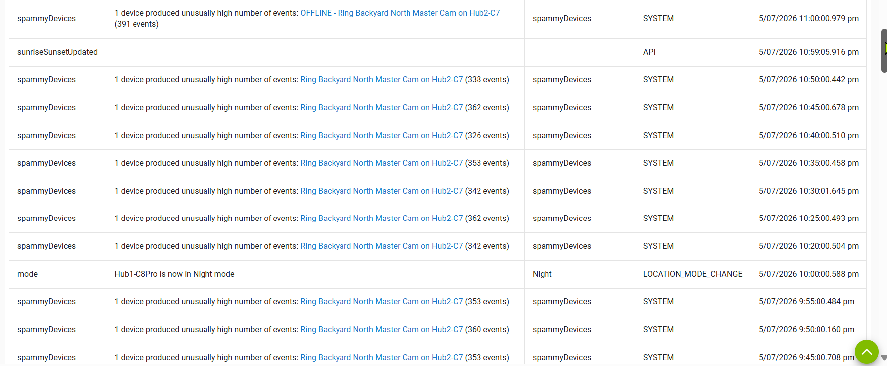

Bryan...I also had my C8-Pro hub bogged down last night/freaking out after I added one of my Ring cameras to a long-standing Room LIghting automation. Previously I only had one of the Ring devices in an automation (the Ring virtual location device) getting changed from home to away by a rule, depending on a Owntracks presence status. So this was the first time I actually was actively controlling one of the cameras via an automation.
Anyway, I opened a door to take dog for a potty break and the Room Lighting automation triggered to turn on several lights (including the Ring cam) and the automation was delayed for several seconds, but did turn on. Then when I returned inside & turned off one of the lights (which triggers RL to turn off the lights) the lights didn't turn off. I tried turning off the actuator directly and that didn't work, and when I turned off one of the lights individually (actually dumb light string connected to plug), the plug turned off and then turned on again.
Couldn't do much detailed investigation at that time as wife and I and were watching a movie and didn't want to derail that. I'll collect what info I can this AM and pass it along to you.
Hub load was higher than normal (usually closer to 2% to 3%).
Ring camera device spamming called out in location events:

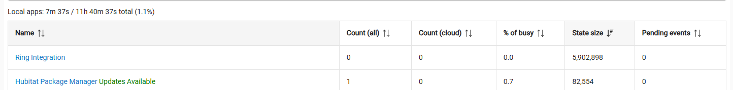

The State size is larger on mine too but didn't see any effects from it yet but I'm on a C8 Pro.
The state size shouldn't hurt anything.. And will be dropping as it's holding a lot of stuff for debug purposes that won't be needed soon..
