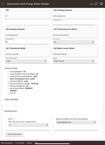

@klinquist, I have updated the app to support the use of either Fahrenheit or Celsius. Is there any interest in adding this to the main code?

Yes, could you open up a pull request?
Will do!
Thanks @Sebastien I made a few changes and merged it in.
Awesome! Thank you!
