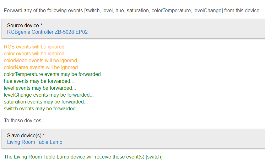

Mike, I have one of these installed and I am wondering a couple of things:
1.) Why is this message about color events showing up in Mirror when I set up the Mirror Me setup?

@mike.maxwell Could I get an answer about the orange text shown in the image above?
How about the parent?
That's normal. You can ignore it
