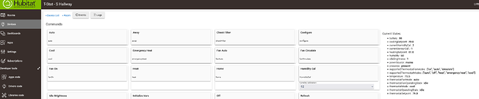

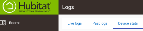

The device stats are from Logs > Device stats:

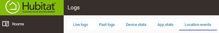

The spammydevices is Logs > Location Events:
The current states are from the device page:

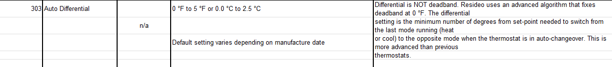

Its been a while but I recall the T6 had an option to report the (either temp & humidity) in finer resolution. This caused a lot of reports so I turned it off.
See: options 1421 and 1426 in the thermostat setting (not in the Hub)

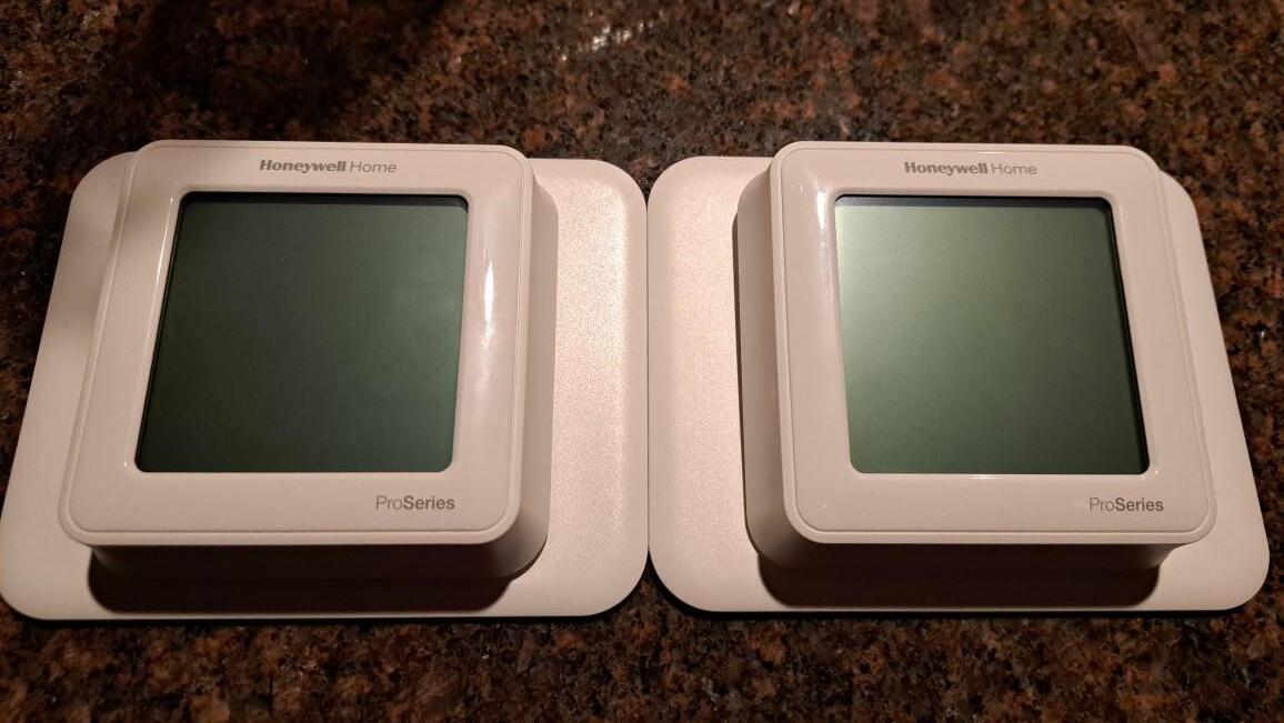

I'm getting two T6's in the mail soon to play with.
Will I be disappointed? :slight_smile:
No. I have 2. They suit my needs very well.
Is there any way to get the filter change alert from the thermostat? My thermostat is currently showing me the reminder to change my air filter (message 181). I couldn't see anything of importance when turning on debug logs and hitting refresh device.
Missed taking a screenshot of the debug log before I snoozed the message. Hopefully it will come back soon.
Is there anything I can provide to help see if the change filter message can be captured by Hubitat?

I did temp to 1 and humidity to 3%. So far, no more Spammy alerts. THANKS @JohnRob for pointing me in that direction.

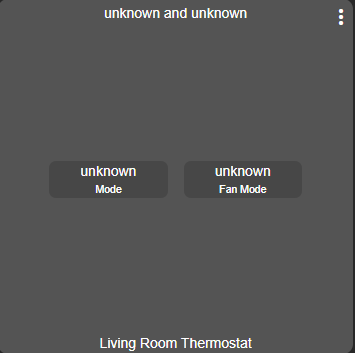

I have been playing with the System Honeywell driver and this one. I did the following:
  • Deleted thermostat from Devices
  • Installed the Advanced Honeywell driver using HPM
  • Ran Add ZWave Device
  • Chose Use Security on inclusion
  • Go to device page and it shows only this:
The log has this:
2024-06-19 04:47:28.218 AM[error] java.lang.NullPointerException: Cannot invoke method toInteger() on null object on line 593 (method parse)
When I try to add the thermostat to a Dashboard and use the thermostat template, it looks like this:
Did you hit configure?
Why are you including with security? Shouldn’t be necessary. Mine work fine without.
