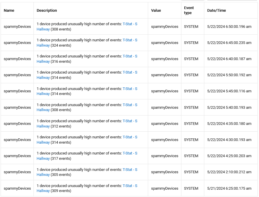

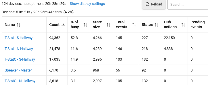

Is there any setting on the t-stat or something else that you can think of that would cause my S Hallway stat to have sooooo much more usage and events?
It is the only device that triggers alerts:
Is it on battery or wired? Weak battery could cause something like that due to retransmissions.
They are both on mains with batteries installed:
