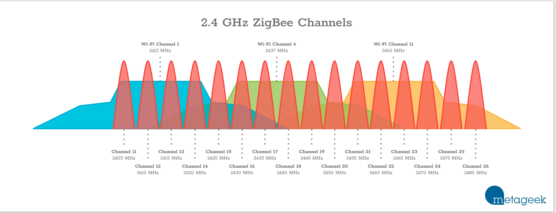

Is your zigbee Channel 20 well deconflicted with your 2.4 wifi's channel?

Yes as it is on Channel 20. If there was an issue would I not see that when I scan Zigbee Channels.

Hubitat's Zigbee Channel Scan is not a reliable tool -- unfortunately, it's very patchy and inconsistent.
Given that you have no other zigbee hubs, what channel is your 2.4 wifi on?
Well thats disapointing news. I always trusted that.
The 2.4 is on Channel 1 and Sonos is on 11. I double checked this with WiFi Analyzer.

Try 15 or 25. We've seen issues before with Ch. 20. I've passed your post on to the Zigbee team. When you change channels, allow about a day for everything to settle, although in my experience it settles pretty quickly.
Thank you so much for getting back to me so quickly, @bravenel! I will try channel 25 and will report back here in a day or so. Thanks again for passing this on to the Zigbee team
