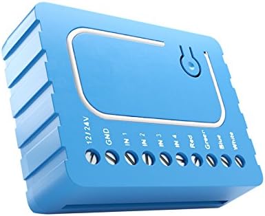

You can do this with two items.
It's a kit of an RGBW strip plus power supply and a controller/remote. It's pretty easy to use that controller / remote to: get it right while building it.
Once it's how you want it, you can replace the controller/remote with:
Or, for a slightly lower price:
Hubitat has a Fibaro RGBW (beta) driver that works well for both. The Qubino throws an error but it doesn't affect functionality. I have a Fibaro and 3 of the Qubino's.
