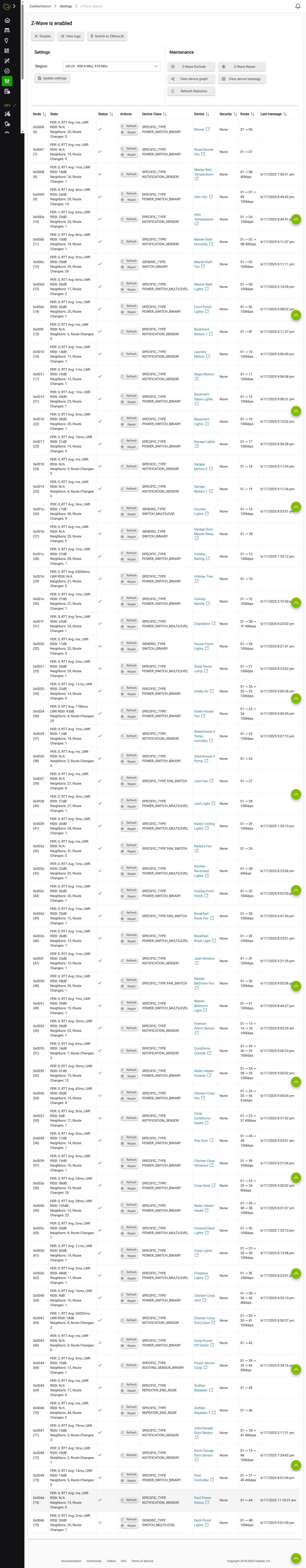

I don't see any ghosts in the details. Maybe the swap devices prevented that...
I keep a spreadsheet with that data. The old ID was 3F which is gone. The device that got swapped in is now 4B.
