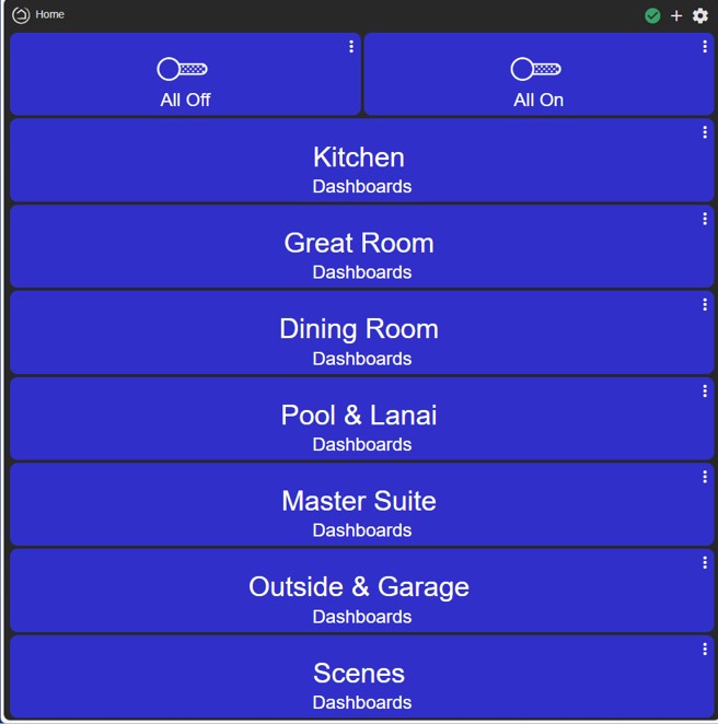

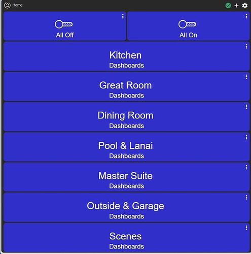

My question here is what is the easiest way to remove the word Dashboards from each Dashboard link button I have on my home page? I was able to make it disappear by setting the text color the same as the background but then I lost the name of the link. Fixed one thing, broke another.
I sniffed around in my browser and found the css code with the word dashboards and over wrote that with spaces and that removed the word for that instance but as soon as the page refreshed the word was back. I am not sure where to find the source CSS file to do that edit there or if that is even a good idea (would I break something else?). I am not skilled in CSS or HTML but could do trivial edits.
I also looked for a parameter to turn off that tag line but couldn't find it. I'd just like to remove the word as it is cluttering my button design and is unnecessary verbiage anyway. See screenshot below.

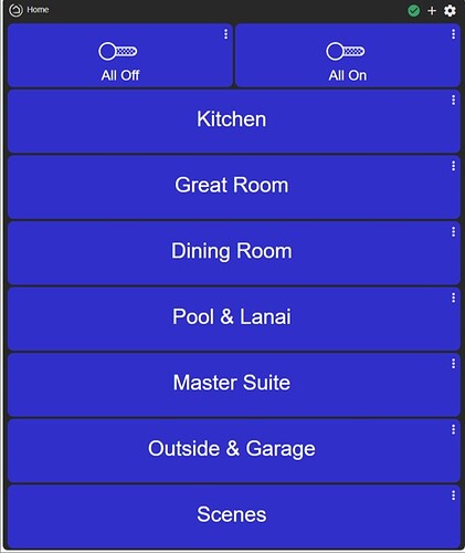

it worked!
#tile-1 .tile-title, #tile-2 .tile-title, #tile-3 .tile-title, #tile-4 .tile-title, #tile-5 .tile-title, #tile-6 .tile-title, #tile-9 .tile-title, #tile-10 .tile-title {visibility: hidden; display: none;}

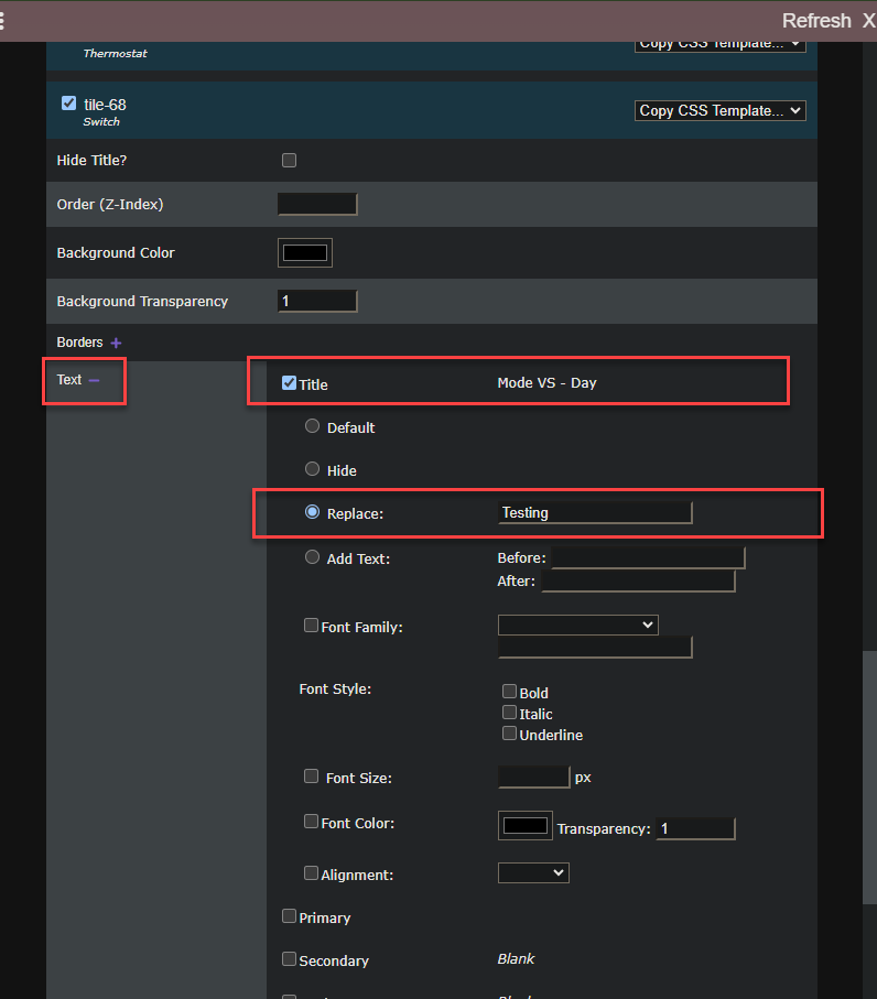

Using the replace option for a tile title in my editor (and the "hide all tile titles" turned off, which I may look at adjusting....) produces:
/* tile-68 Settings */
	#tile-68 .tile-title { visibility: hidden; }
	#tile-68 .tile-title:after { visibility: visible !important; position: absolute; left: 50%; top: 50%; transform: translate(-50%, -50%); overflow: hidden; white-space: nowrap !important; content: "Testing" !important; }
