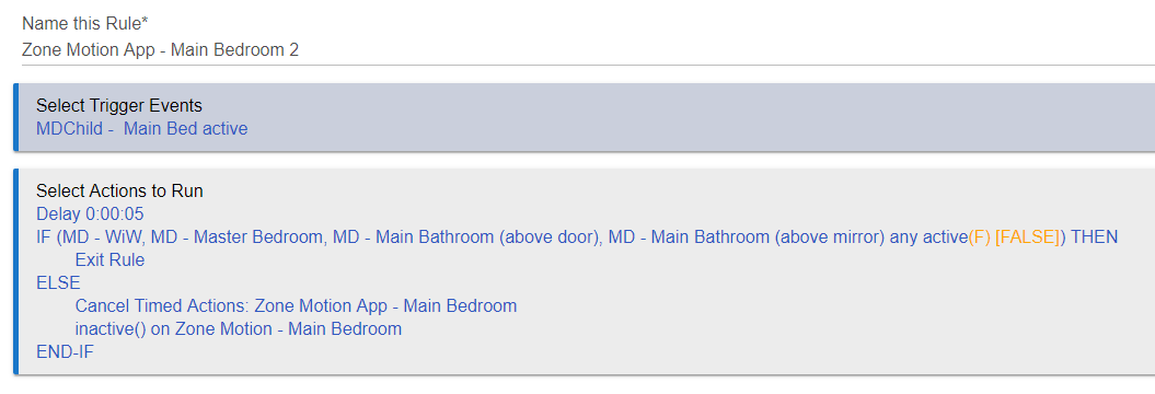

Thanks for the help. This is what I settled with, and it seems to be working now (with limited testing). I used wait for event on the already triggered motion sensor, but this time "inactive" (which is 20 seconds for no further movement). If at that point, the other motion sensors are also inactive, then turn make the zone motion inactive. There's no need to put an ELSE in the yellow, because if the rule is retriggered, the waits are cancelled, according to the documentation.
The trick will be ensuring the motion sensor timeouts dont conflict with the 25 second wait.
Thanks again.
