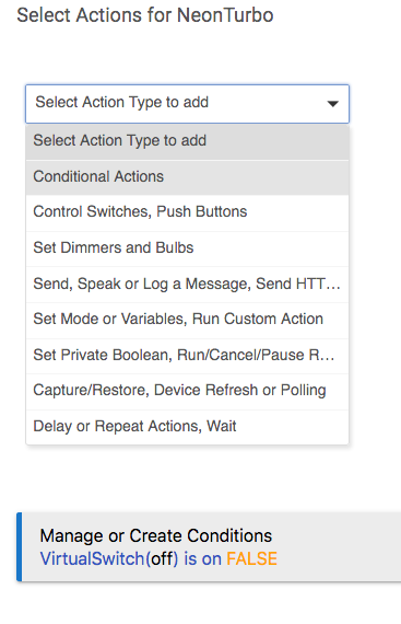

I click Select Actions to Run and get:
I click Conditional Actions and get that choice...
