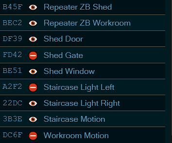

They don't need to be powered on.
That button has nothing to do with Zigbee, please don't click it :smile:

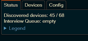

Minor UI request: can the selection of "Show link particles = OFF": be made sticky, so that I don't have to turn it OFF every time I run the app?

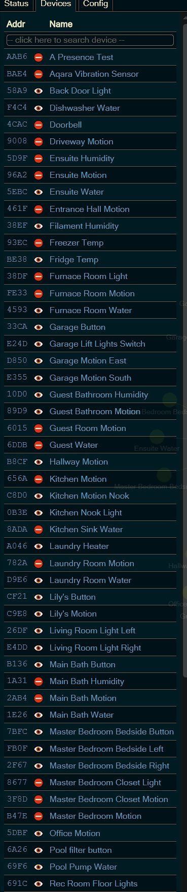

I really, strangely enough, "enjoyed" running this and seeing my map and its 100% population.
In the last 6 months all is ZB well but the map, or storage of that info in the controller, sure makes the enjoyment tepid. :wink:

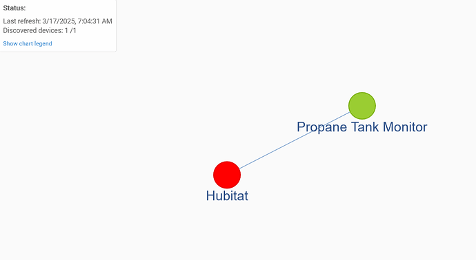

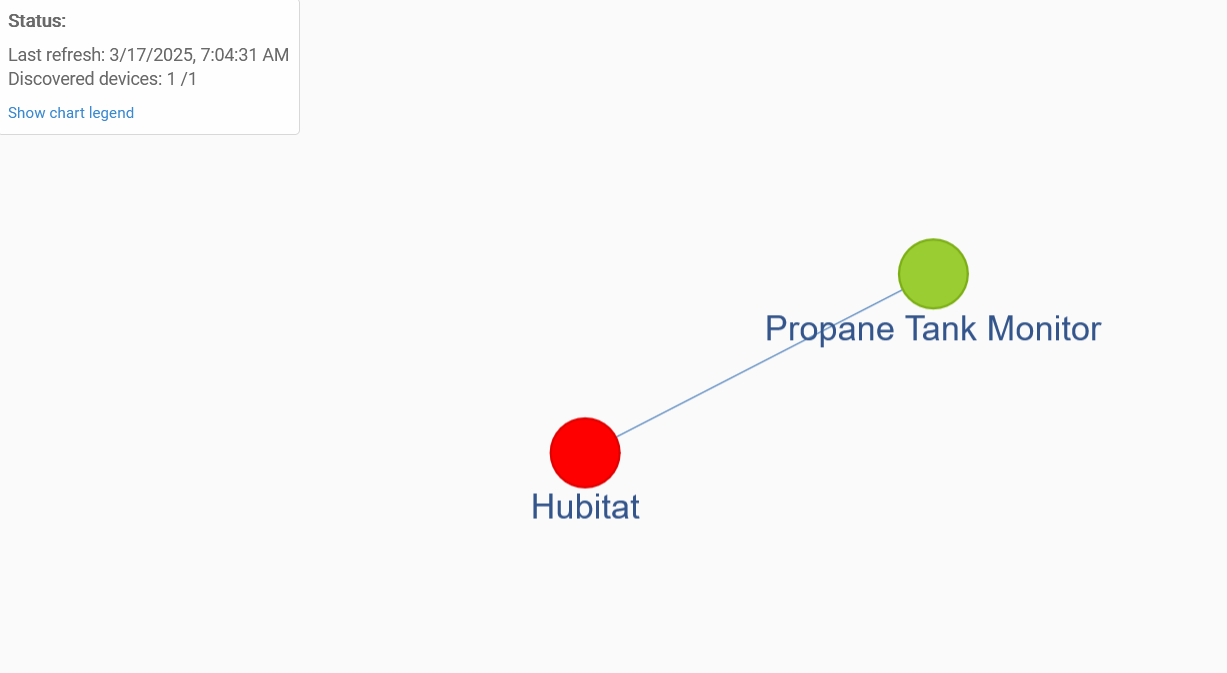

I'm thinking I don't have a need for this app. :slight_smile:
...yet. :grin: :laughing:
