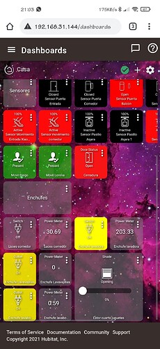

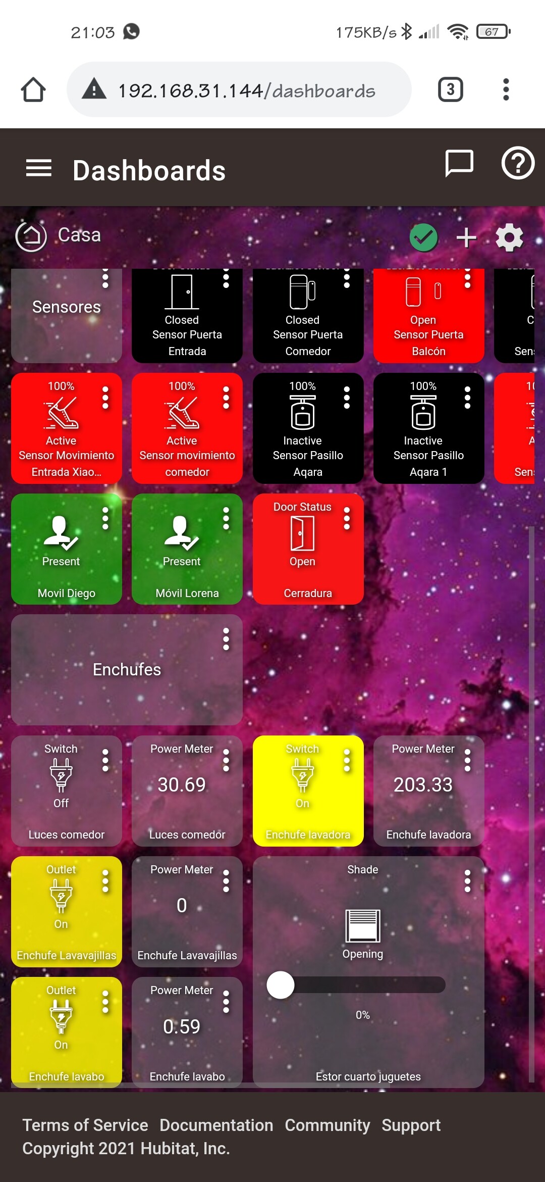

I still have the same problem, I raise the blind and lower it, but I do not get the percentages in hubitat, I get 0%, any ideas please
When you set your status tile, pick attribute then pick position. It's a bit difficult to understand some of your questions which is why I only just realized what you were asking
Here I show you my image, it comes out 0, I upload it to 50% and it goes up, but if I go back to hubitata, update my dashboard it comes out at 0, the status is not saved
And you are using the attribute in the tile display? Also what firmware is your hub on?

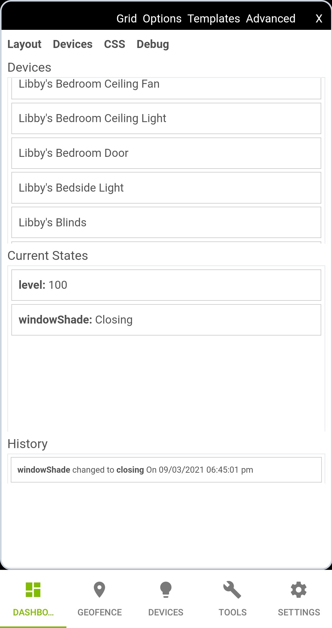

I'm having a similar problem.
As you can see in the screenshot below, the close command was sent at 6:45pm, it is now 7:40pm and the blinds are closed, the level states 100% but the status is still "closing" and on the dashboard, the icon reflects that it thinks they are still closing.
Both rooms haze Zigbee plugs in each room and they are actually directly above the hub so I don't think the Zigbee network would be the issue. In fact each room has a Hampton Bay Zigbee fan controller and these are extremely sensitive to a poor Zigbee network and they both work flawlessly.
