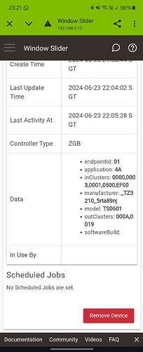

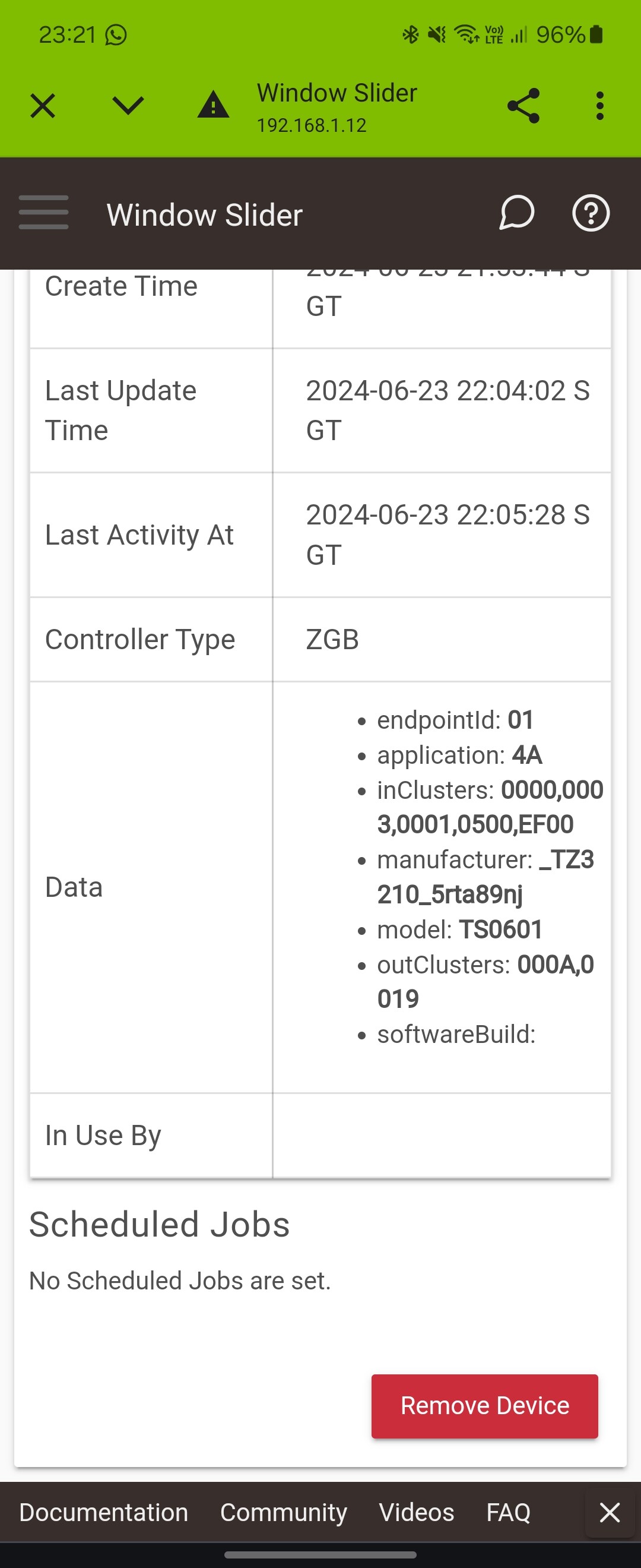

Hi guys i just bought this sliding window pusher , i'm unable to use this driver or any other driver in hubitat. Anyone can kindly point me to the right driver? Pls advise. Thanks in advance.
I too have one like this. It will pair after many tries then within a day will no longer be responsive.
