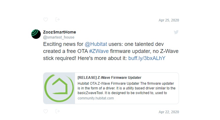

Looks like TheSmartestHouse .com site is even excited for the Z-Wave Firmware Updater!
Again "Great job", @bcopeland
