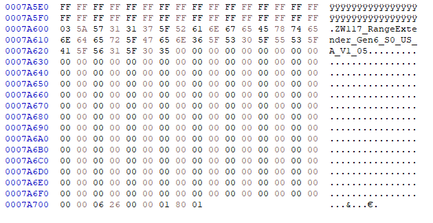

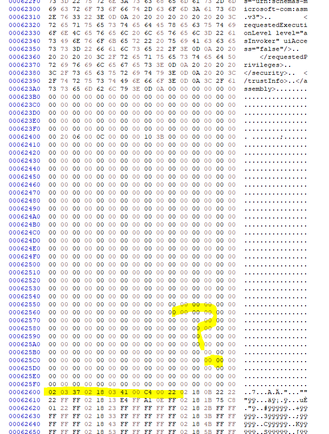

Ok, went the down rabbit hole with bin and hex stuff, but got a little stuck. The only obvious part is the end of the BIN where I can see the filename of the firmware and presumably the firmware itself proceeds that, but I'm not really sure where the 'other' stuff ends and the firmware file begins. Is it just after the manifest xml data in the bin? I'm trying to extract the Aeotec Range Extender 6 Us at the moment .
The end ...
The beginning? ...
That’s it 07A5F0 starts the filename and isn’t part of the firmware
the last 4 bytes is the size of the firmware binary.. In this case: 98305 bytes
