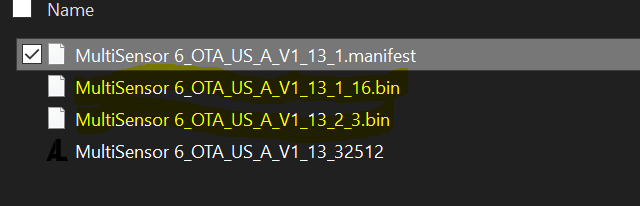

Let's say I extract an Aeotec EXE using the Resource Extractor recommend above and now I have my resource files ..
I am going to use srecord to convert these to HEX, but my questions is, do I covert/merge both of these to one HEX file, or am I only supposed to use one of them?
No.. Those are 2 different firmware files.. You got that from 1 exe?
Yes ... same files as someone posted above ... image
Hmm ... I see a pattern here. Here are the extracted files for the RangeExtender ...
