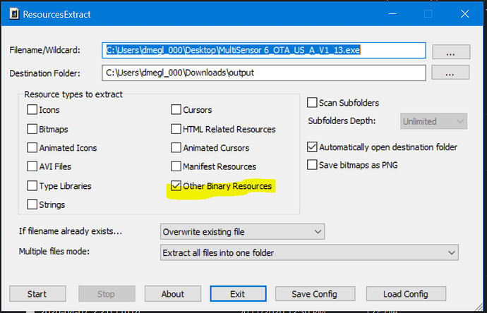

I think ResourcesExtract - Extract files (bitmaps, icons, html files, and more) from dll files will do the trick.
Make sure you check this:
That gave me the following:
I take it this is pretty much what is needed?
got it. thanks a bunch :superhero:
Close.. you still need to convert the bin file to Intel Hex format
