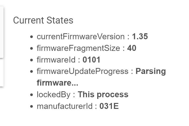

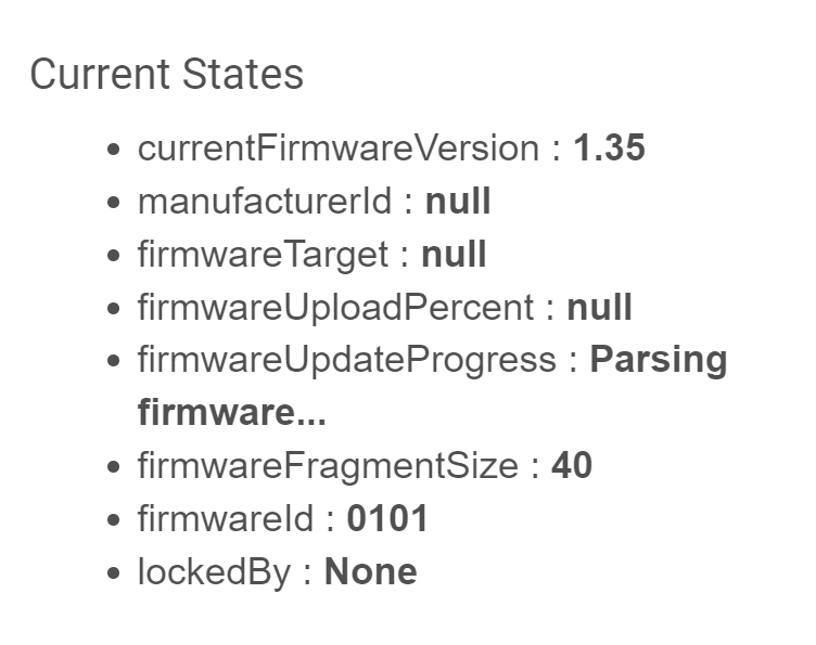

The update process quickly moved to parsing firmware and has been sitting there now for ~20 mins
Here is the URL that I was able to locate
Nothing in the HE log file so far
Is it stuck or ???
If it is stuck on parsing.. Then the firmware URL is not valid..

TY, I used your URL and now I see a Mfg ID
Still sitting at parsing FW...
Hit abort wait a couple seconds .. the. try again with that url..
lockedBy: this process tells me the previous attempt wasn’t aborted..
TY Sir, currently at 21%
