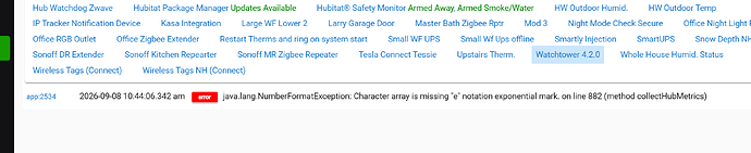

Updated my 8-Pro hub to 2.5.0.136 and I'm now getting this error from watchtower 4.2
FYI.

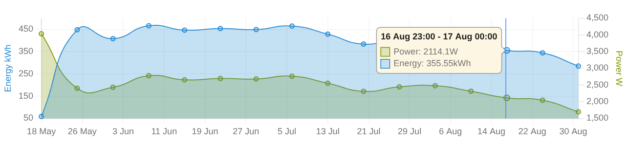

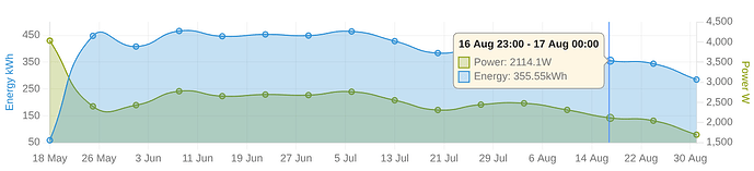

Anyone else notice that the tool-tip in weekly view shows the wrong date/time range?

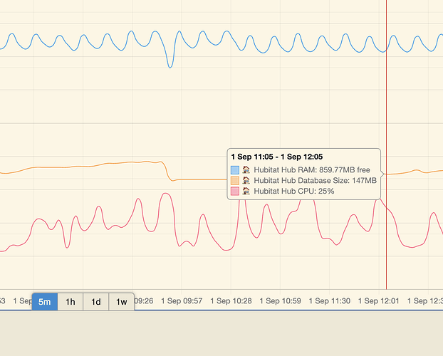

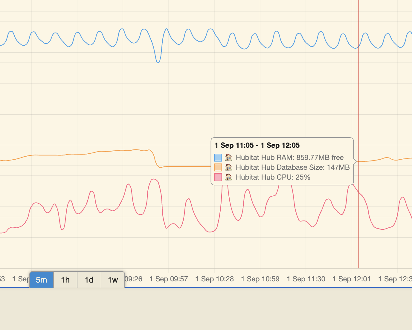

The 5 minute graph is also incorrect. The end time appears correct or close, but the start time is 55 minutes too early.

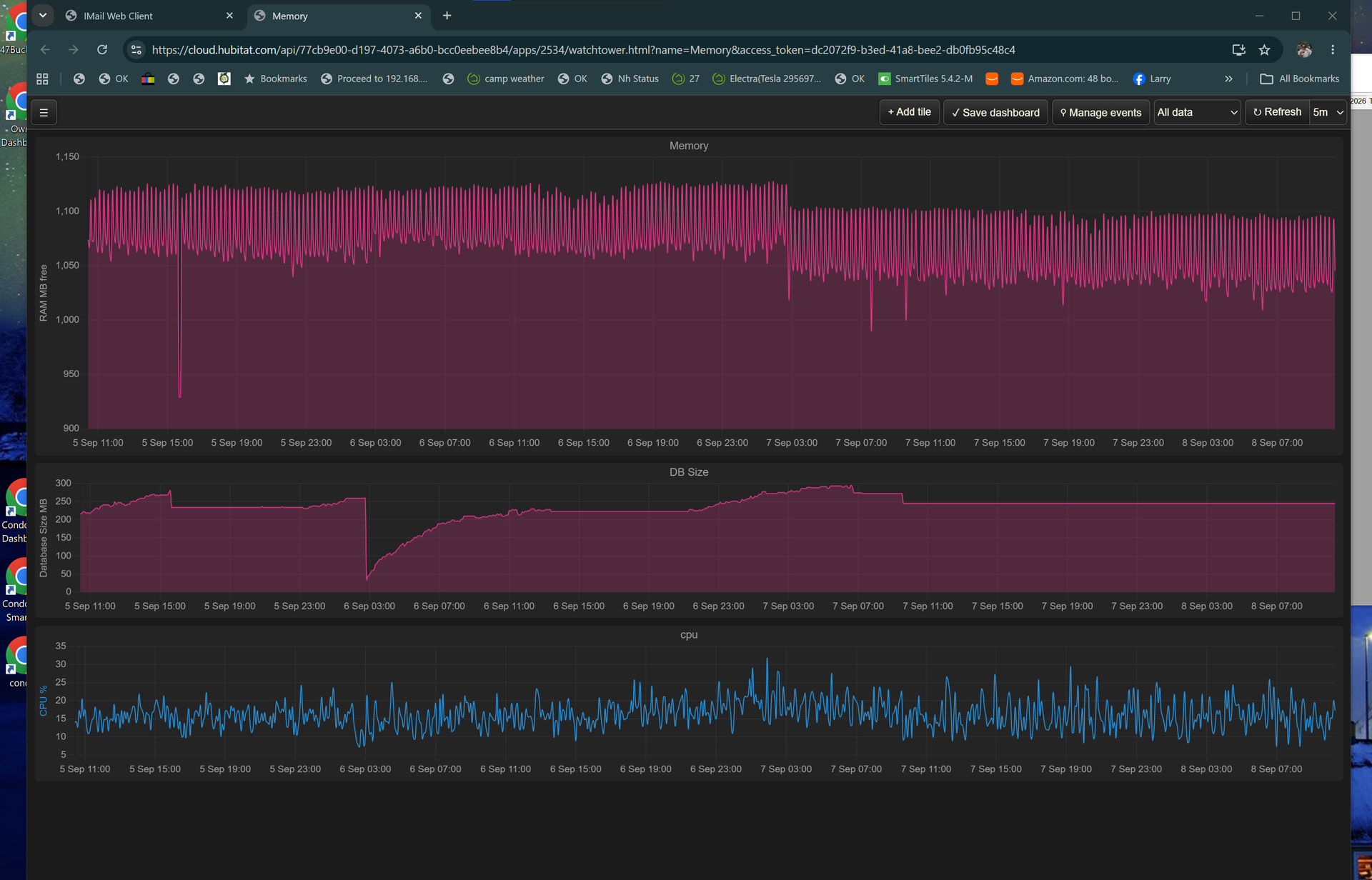

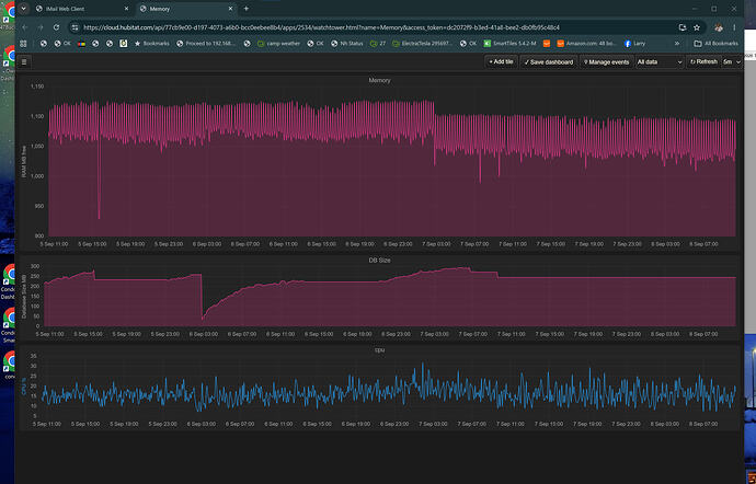

getting an error in logs and the db size is not changing how to fix?
