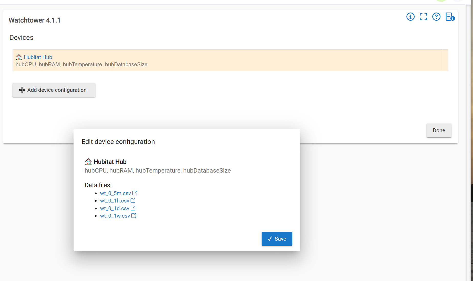

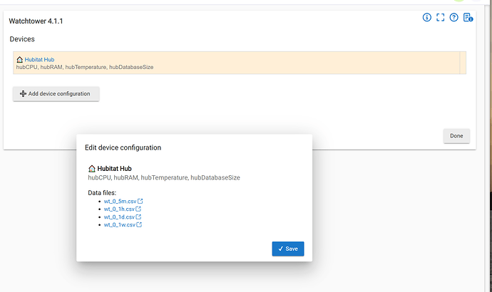

its not just that there is no way ever to delete it.. no delete button on the app device page as well as it doesnt show up in devices
here is the issue.. there is no delete option at all on the device configuration. and removing and reinstalling the app also doesnt delete it..

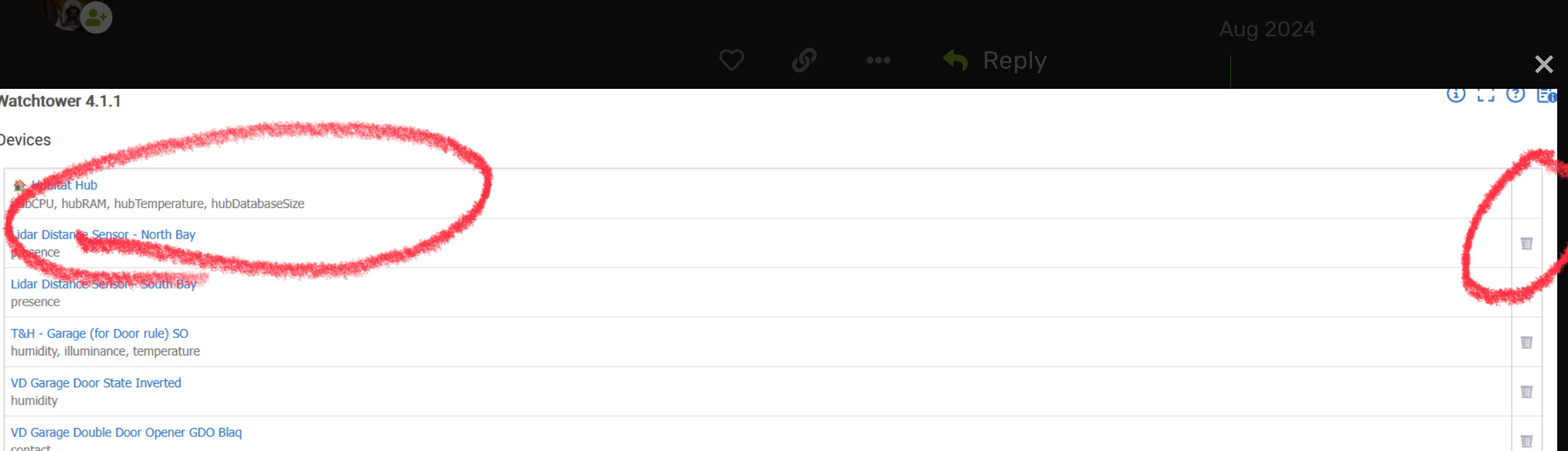

I'm running WT 4.1.1. I see a trash can icon to the right of every Device that will remove the device and it's associated data files.
weird no trash on mine see above pic
Maybe in your color scheme you can't see them??
Judging from both of your screenshots it doesn't look like the hub attributes create a device to delete.
no I'm thinking it's a bug if the text is too long it doesn't appear
watchtower doesn't create actual devices. its picking devices that already have attributes to graph

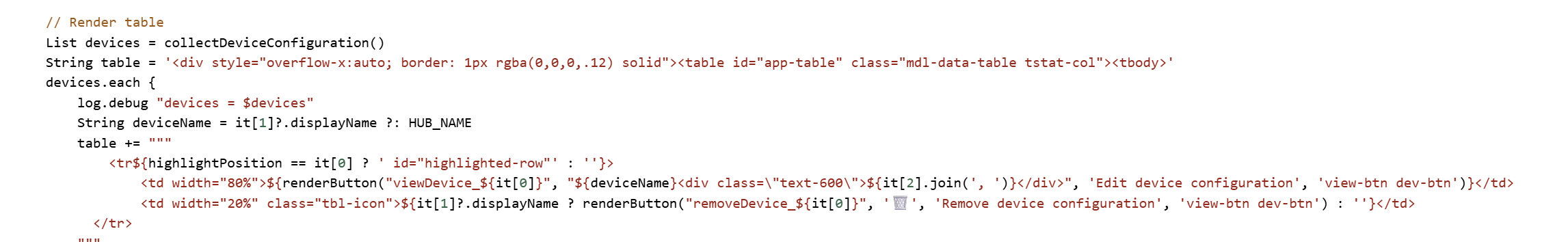

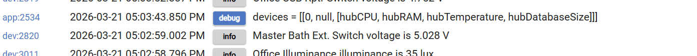

you may be right i put a debugging line in showing what the devices are returned in the code that generates that html
in my case the 2nd item is null and that is what is used to generated the button,
not sure why it is null?
Oh, now I see what you mean. It's not a bug, the "Hubitat Hub" entry is added by default when the app is installed, and cannot be removed.
thanks now I see what your talking about. ok not sure why it started errors on a hub update. that's why I was trying to remove it. only recourse was a total remove and app and restall. sorry to bother u

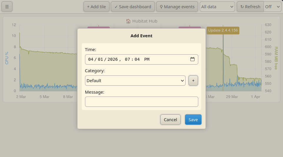

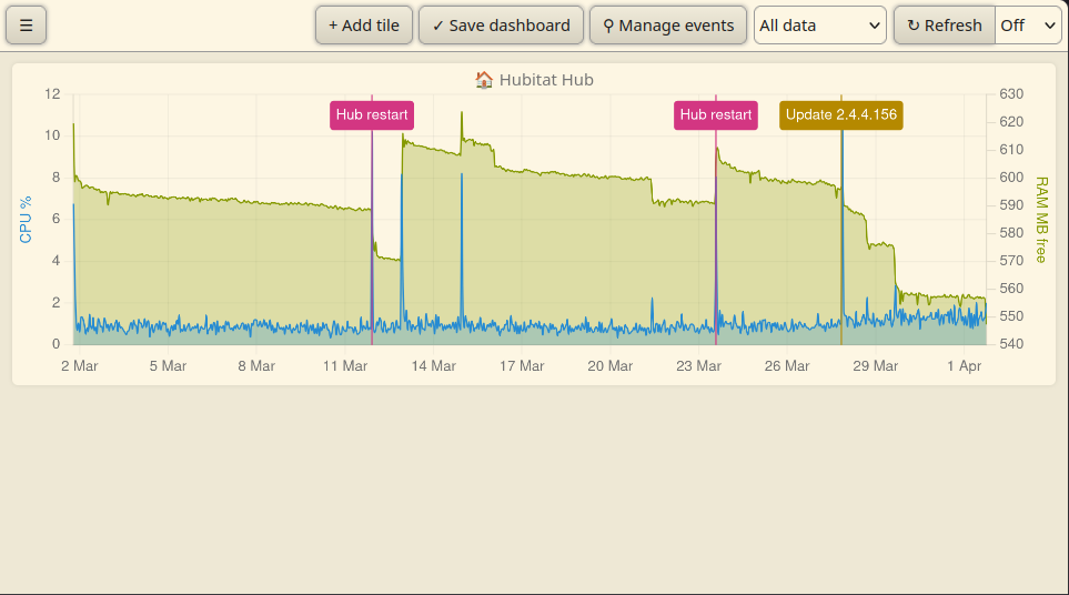

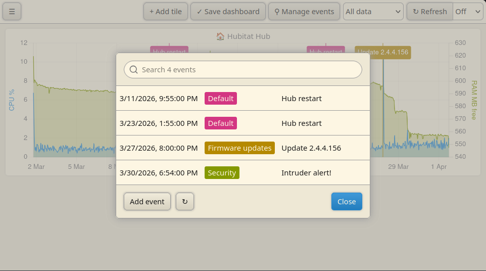

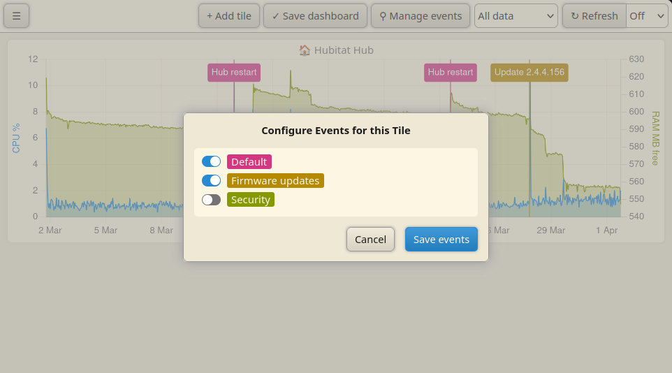

Released version 4.2.0 with the following changes:
Added
  • Add graph events - @Slate

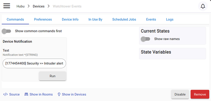

  • Add Watchtower Events (optional) driver to help add Watchtower events from automations
Changed
  • Big overhaul of the HTML/CSS with minimal UI impact
There is also an optional driver available if you want to create events from automations, not just from the UI. To install the drivcer code, first update to version 4.2.0, then use the Modify option in HPM.
