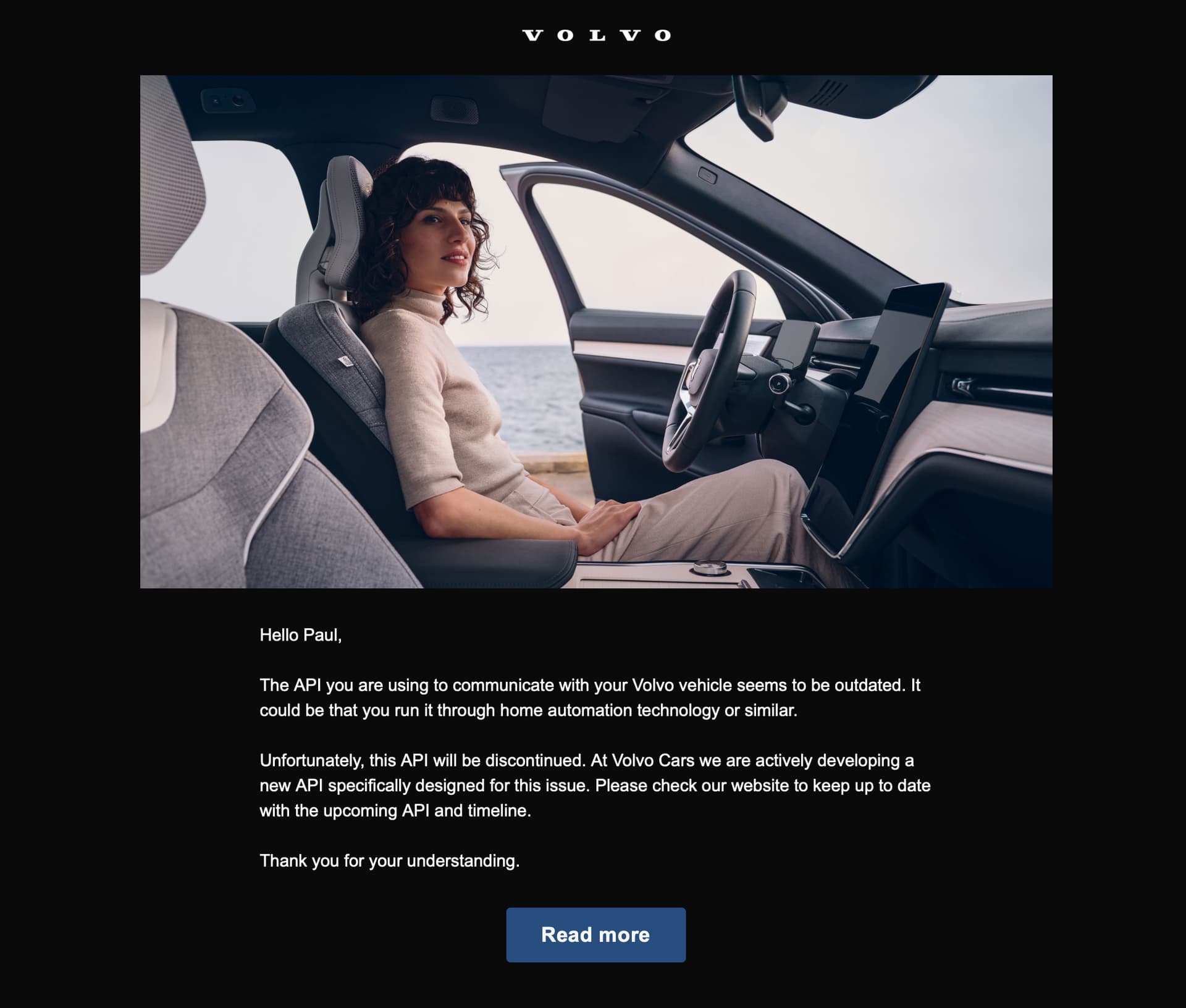

This email received this morning (UK user):
Oddly, the link in the email points here:
