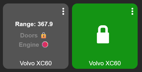

Any interest/thoughts in a dashboard widget? I usually just have mine listed out with the lock status (the second block), felt it might be nice to report out the full status of Range, Locks, Engine, and Charging status (not shown).. I'm thinking something like the following, still playing around with it:

  • Enh: Added the dashboard attribute
