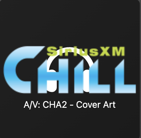

I have been using this driver for a long time now with great success. I recently ran into an issue and wanted to see if you could think of a workaround. I am using it to display cover art to 12 zones pulling from the various media sources. I recently updated the rules to pull the channel image from a Sirius XM channel while it is loading and until the first cover art is provided. The channel image is also in the sirius XM feed and has a transparent background. As a result the transport commands show through. Example:
I don't know if this is something on the driver side or the Sharptools side so happy to take the conversation there if appropriate? Thanks.
