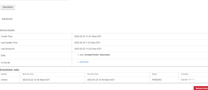

Actually, the recording of this c, p and w did work for me, was just looking in the wrong spot. Check the device details section, just above "in use by". There should also be an ip address Next step will be to see if there is anything in the logs to indicate why the command didn't work...

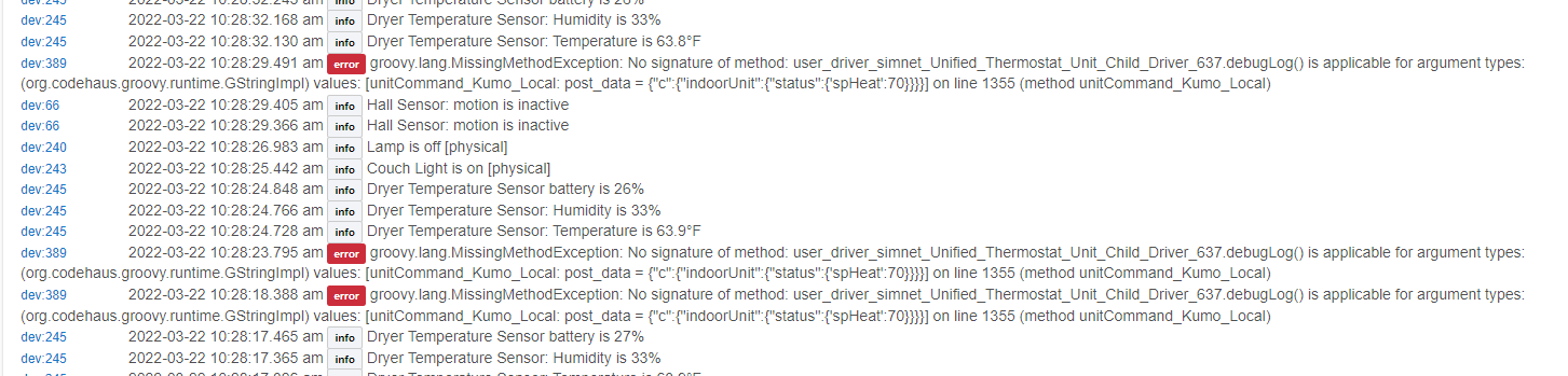

I can see what the problem is, a typo by me, missing a v in front of a post_data variable reference. I'll see if I can get a fix out before I travel into work (about 5 hrs time)
Great... but no rush.

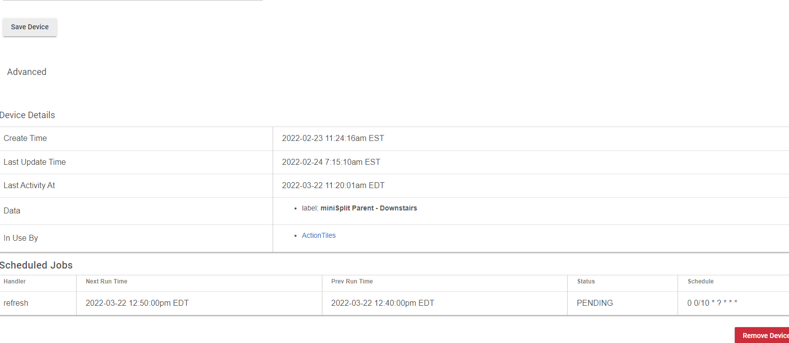

another FYI... I don't see any IP address above "in use by"... or anywhere in the device page. I also don't see any entries in the logs either. But keep in mind i'm still a novice with hubitat. And the only errors I see from the logs has to do with my Garage MYQ and it reading the battery level.

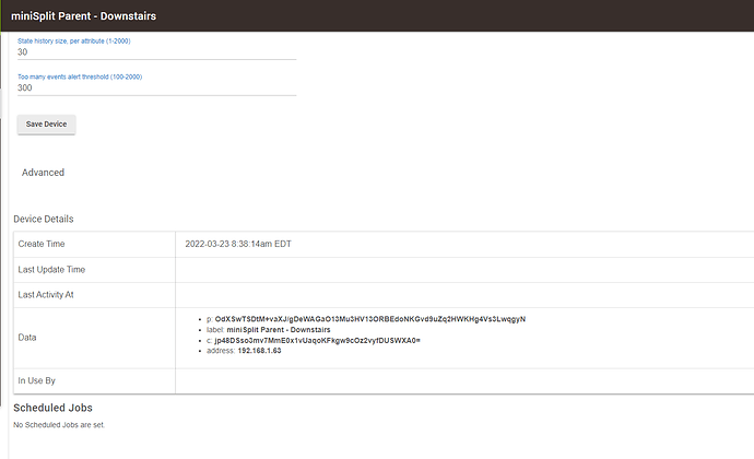

Hi @tohm, I've updated the child driver to hopefully fix the issues you found. You can take it again from the link I posted previously and overwrite the driver on your hub. I think you will need to remove the child devices, then run the refresh on the parent device, but I could be wrong. If that will cause you any issues, let me know and I can take a look, but might be another day or two before I get to it....
Hi Simon,

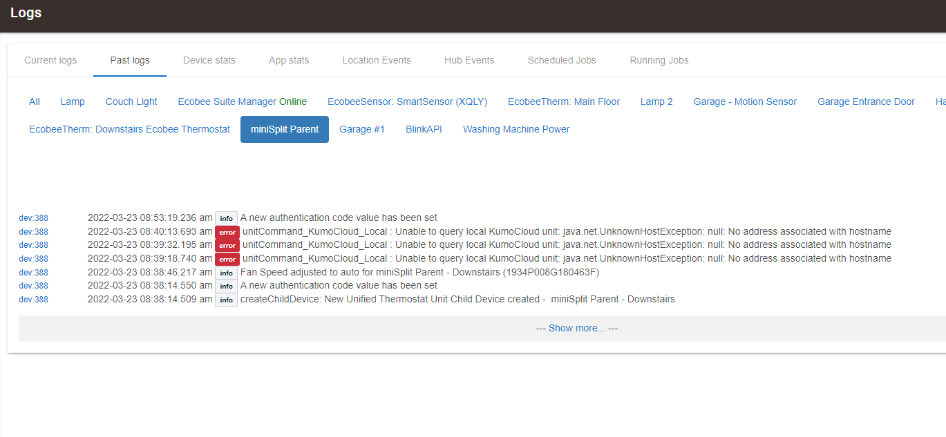

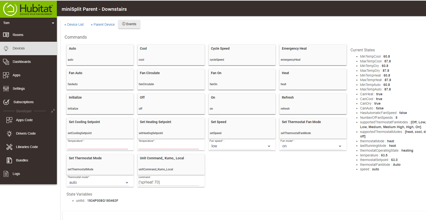

I deleted the Child, updated the Child driver, did a Refresh. The Refresh auto created the Child and now I see the IP and the W, C ... However, when I issued the command to increase the heat to 70 degrees... nothing happened, or at least what I expected should happen. Here are some screenshots...

You can try again, just update the child driver code and try the command again.
Updated the driver, did a refresh... saw 1 new line from the log
dev:3882022-03-23 08:53:19.236 am infoA new authentication code value has been set
Issued the same command but it did not set the heat to 70 degrees.
Did you not see a debug log when you tried issuing the command? Starting with:
unitCommand_Kumo_Local: Initial data returned....
Sorry, I wish I had more technical understanding ... when I go to the logs, I select everything from dev:388 and this is what I see...

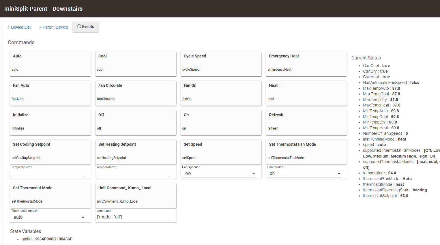

I also now tried a different command... turn off mini-split
Unit didn't turn off... no log entries and no event entries either

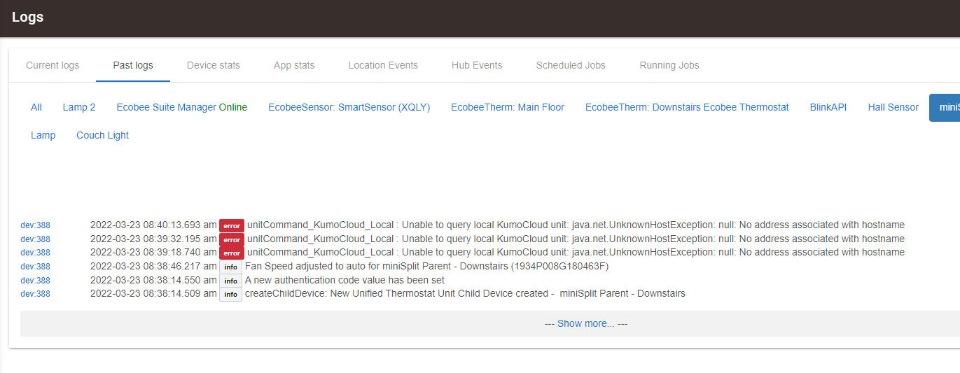

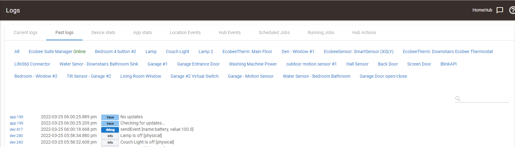

Just getting back to this now. I noticed in your last logs screenshot you were still looking at the "Past Logs", selected at the top of the screen. Could it have been that you needed to change this to the "Current Logs" to see the debug messages I was referring to? Are you able to test this again for me and see if any new debug messages show up? Or even just look at Past Logs now, to see what showed up a few days ago when you tested the changes I made. Thanks.
Like before I was searching through all the logs (current and past) but I don't see a "debug" for this device. I just now checked the past logs again and I don't even see any logs since then for the mini-split. Even now when I tried to issue a manual command to increase the heat.
minisplit 1
Is there something I can do that would force a log entry?
SUCCESS!!!
With debug logging turned on, @tohm and I were able to work out we just needed to include double-quotes in the commands being issued. We were able to see a temperature change take effect, which was a great outcome.
The change in temperature did take about 20 seconds to take effect. We then tested without an Internet connection and it did not work, so there's a little more to be done there.
I have updated the notes I posted for anyone wanting to test, adding the double-quotes. We also worked out we needed to supply Celsius values, which lines up with what Kumo Cloud expects.
