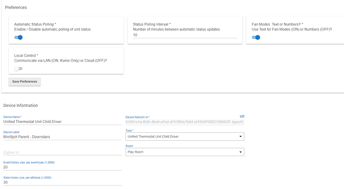

  • You should now see W, C and Address entries in the State Variables (just below the commands) - looks like I have thing wrong.... I will looks at this and post back when it is fixed.
  • You can ignore the new Local Control preference setting for now
  • You should see a new command called "unitCommand_Kumo_Local", which we will use for testing
  • Paste in any of the follow text into the command parameter and click the "unitCommand_Kumo_Local" button to test different commands. For the last two, replace "value" with the temperature value you want. Temperature values need to be in Celsius.... I'll eventually do the conversion in the driver.

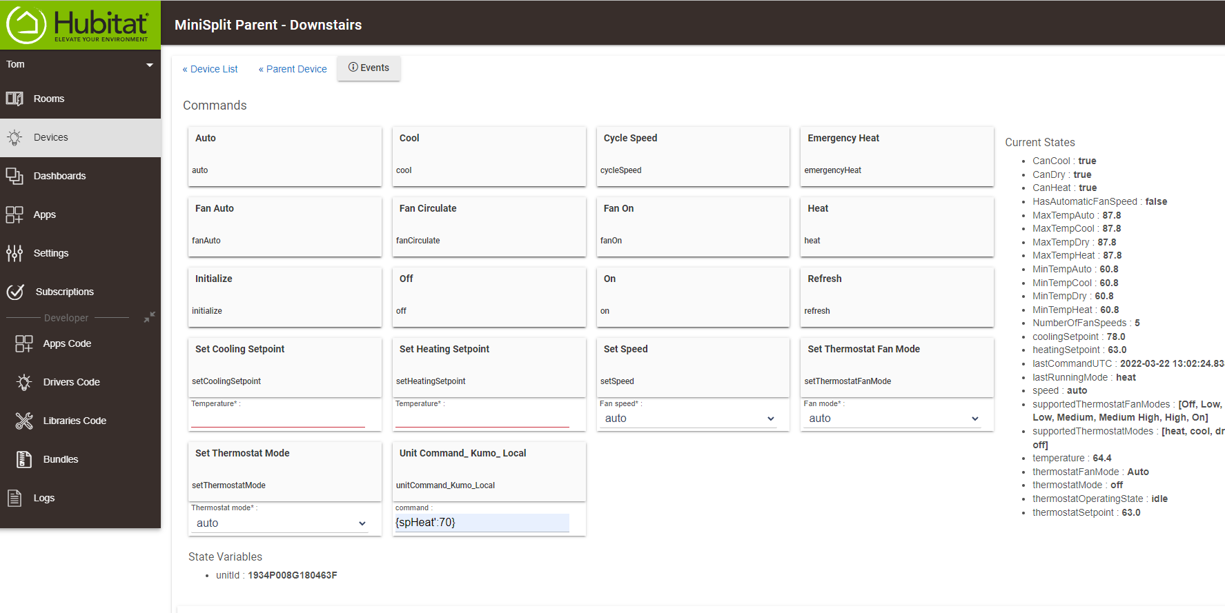

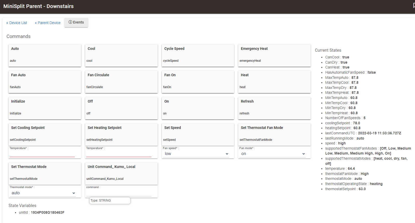

yea... I'm a bit confused with were these w and c values are ... I updated the drivers, did the refresh, click on a child... and this is now what I have:
Does this look correct to you?
I tried anyway to issue a local command to change the heat point but it doesn't look like it took...
Let me look into it. Thanks for giving it a go
OK... FYI, I noticed I had a syntax error in the command... missing a ' ... I corrected the syntax and still the change didn't happen.
