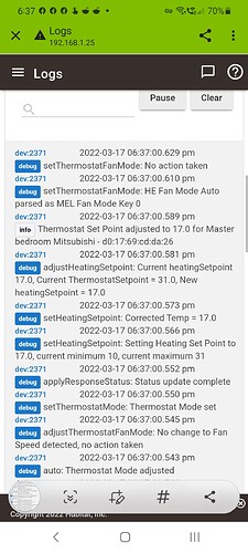

Here's the logs (screenshot from mobile).
Seems it knows that the temperature set point in the mitsubishi app is 31 degrees. Tries to send 17 degrees auto from hubitat. But next time you can still see that your driver still sees it as 31 degrees (which it is in reality and in the Mitsubishi app still) and tried to change it to 17 dgerees again (unsuccessfully).
I'm sure I could explain that better so let me know if that isnt clear enough, well more well structured.
Here's a longer log. Sorry for screenshots as I wasn't sure how to attach logs from mobile easily..

Ok. It seems that the fan changes regardless of other settings. So fan works as expected.
If I change just the temperature in hubitat then the apps temp set point doesn't change.
If I change the mode only then the mode changes in app.
If I set both the temperature and mode different in hubitat than they are in the all then they both update. So to see a change in the app I have to change the mode as well.
