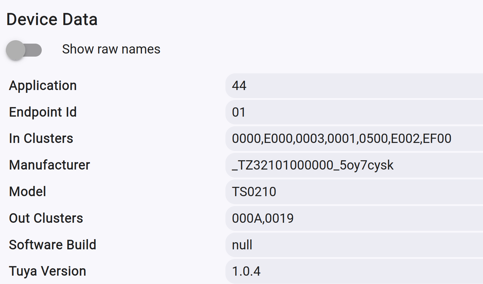

This is the info:
fingerprint profileId:"0104", endpointId:"01", inClusters:"0000,E000,0003,0001,0500,E002,EF00", outClusters:"000A,0019", model:"TS0210", manufacturer:"_TZ32101000000_5oy7cysk", controllerType: "ZGB"

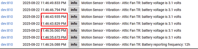

Here’s another mystery, bougth 5 of these from AliEx, and typically on pairing they are not happy and report constant activation, like every few seconds. I’m not sure what caused 2 of these to start behaving normally. Just paired another one, it selected your Tuya driver automatically, but is now going off every few seconds. I tried re-pairing it next to the hub. Also removing batteries, several configure, but it won’t stop self activating. All of these have identical settings and firmware.
Application 41
Endpoint Id 01
Manufacturer _TZ3000_lzdjjfss
Model TS0210
Tuya Version 1.0.1
