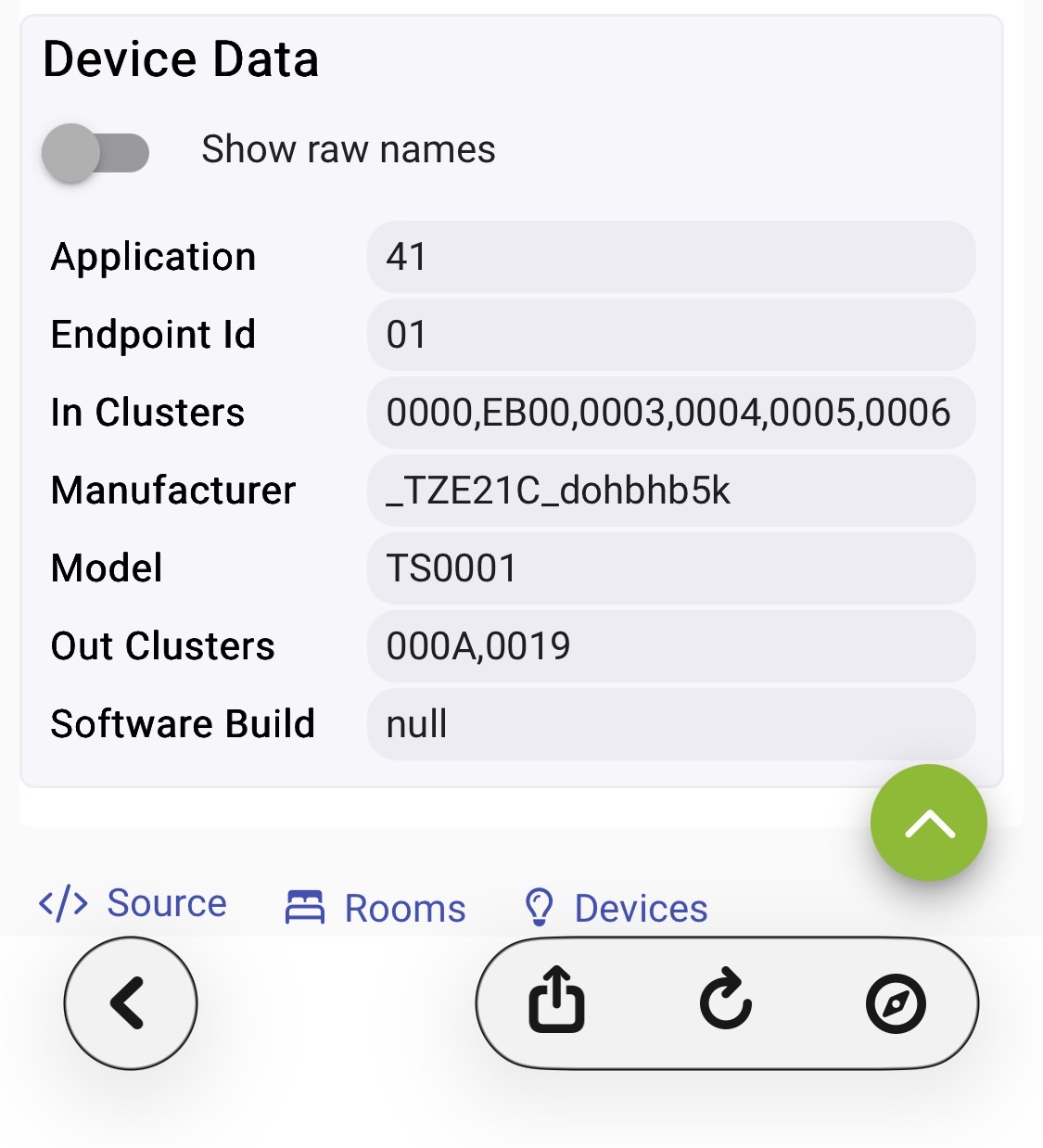

Please follow the instructions for identifying your device…
Driver installed, floor heating up, currently no warnings. I think this is going to work; if there are any problems I will let you know. Many many thanks!

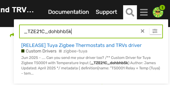

Your device unique Zigbee Manufacturer ID is _TZE21C_dohbhb5k
Searching for it in the forum shows this post :
The dedicated driver in this post should be working with your device :
