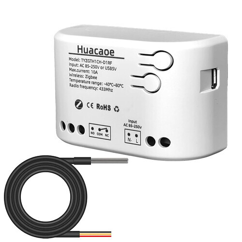

Team, Model of Thermomostat below. kkossev I will try your updated driver and see if thatmakes changes.
Thank you for checking the issue with scientific notation. hopefully not too tricky.
