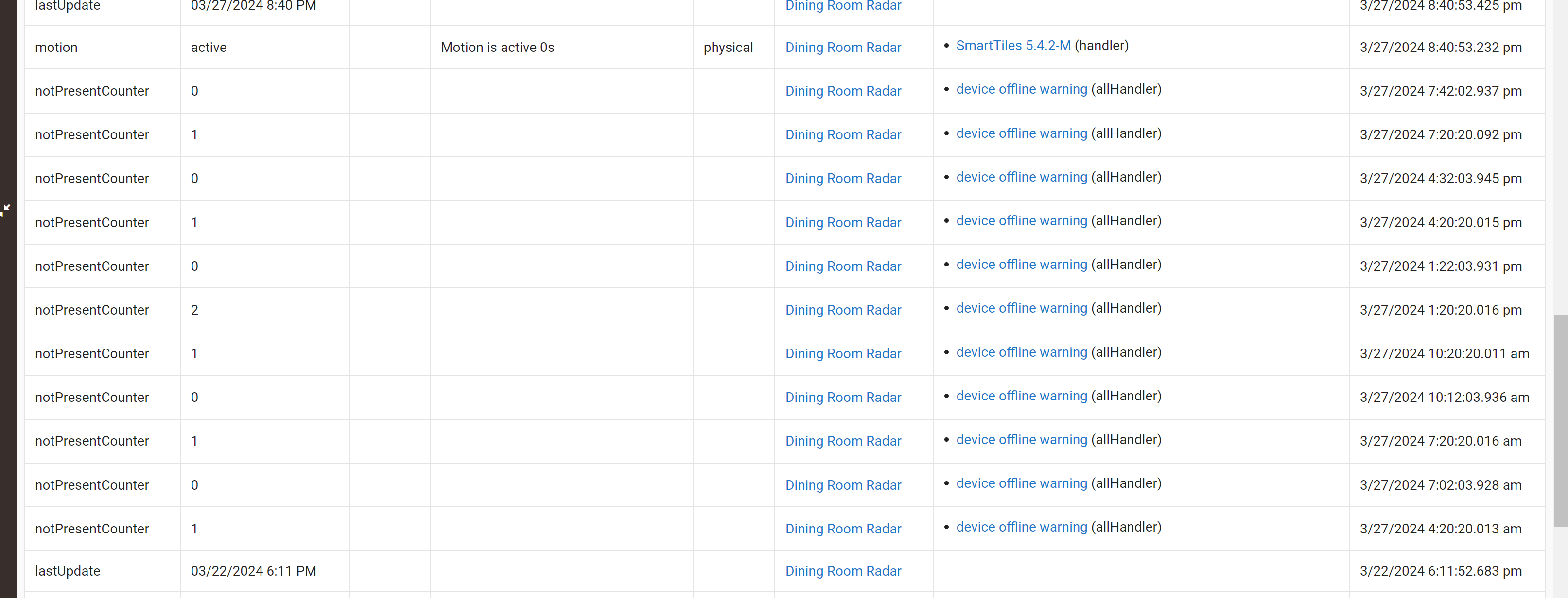

my device also stopped working after about a month. even though physical device seemed to be working ,.. ie blue light flashed but no events being sent through driver? Any ideas what is up with it? I unplugged and replugged in and started working immediately with nothing else done..
so now i have added a usb switch to it so i can reboot when necessary..

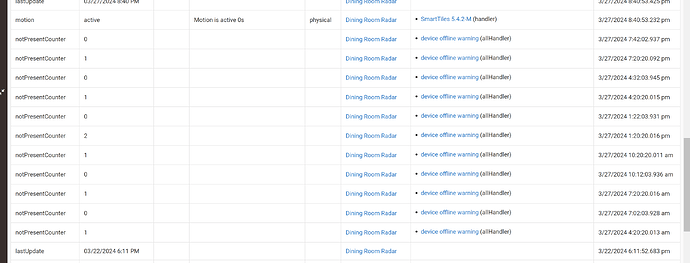

the weird thing is that the notpresentcounter attribute would toggle on off when there was motion but didnt keep on. so there also seems to be a problem with that..
ie
@kkossev
The Tuya 4 In 1 driver does not send events for an attribute ‘notPresentCounter’ or ‘last update’ … are you using some of Markus’s drivers?
no its yours.. i added last update. and i saw your driver set a state.notpresentcounter and modified it to set the attribute in the same place.. ie.
so back to the issue it would appear the device driver was getting some messages but not motion etc. so would you recommend something maybe turning on debugging next time to see what messages it is getting to figure out what weird state the device gets into where the light flashes and messages come through but not motion, etc.?
or maybe just change my rule to toggle the switch to reboot the device as a workaround.., but it would be nice to figure out what is really going on first before i do that.
OK, I can add these 'notPresentCounter' and 'lastUpdate' attributes as an option in a future update of this driver. By default, the new option will be disabled.
Have in mind, that any event that is sent while the device is actually offline (no communication to the HE hub) will re-trigger 'LastActivityAt' device property, which is used in the DeviceActivityCheck app :
This shouldn't be a problem for these devices that use the 4-In-1 driver, as the Device Activety Check app can also be triggered by the healthStatus attribute change.
Yep, just turn the Debug logs on at the time when you notice the same issue.
The debug logs will turn off automatically after 24 hours ( not the usual 30 minutes as used in most of the other drivers - 30 minutes period is too small to include the events that we need).

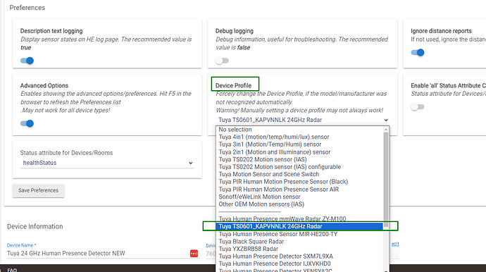

I suppose it is a new manufacturer of this device :
To make it work, simply select the TS0601_KAPVNNLK_RADAR Device Profile and save the preferences :
I will add the new fingerprint in the next driver update.
That seems to have fixed it, @kkossev - thank you so much! Had three follow up questions if you don't mind:

When you change a preference, click on the ‘Save preferences’ button only. Can you successfully change other settings, like sensitivity or maximum distance?
@aahanmohan please hold on, I see now that the preferences for this radar are missing, probably something got broken for this device is the latest driver version.
I will notify you when I have it fixed ASAP.

Hi @aahanmohan ,
Please update the driver to the latest dev.branch version 1.8.1 '2024/04/16 10:34 PM'
I think that I have found and fixed the bug in the previous versions. After the driver update, refresh the device web page (F5) You should see this model preferences now.
It is better to try to avoid the interfering moving objects (like the ceiling fan) by aiming the radar lower, toward the floor. Also, decrease the sensitivity parameters to the minimum needed to detect a human standing still.
