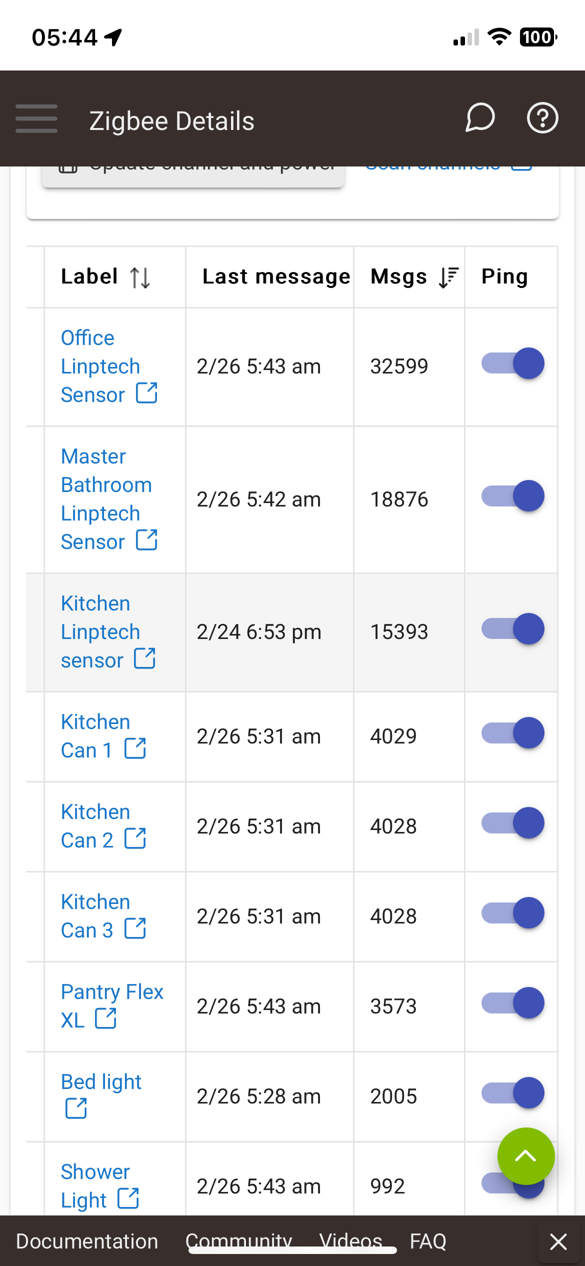

The top 3 devices are Linptech mmwave devices after 3 days of uptime. The busiest area is the kitchen. The difference is that I covered the lux sensor on the kitchen Linptech.
I will be covering the sensor on the others as well since I use outdoor Hue sensors for lux readings.

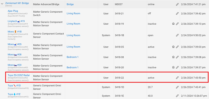

As you have 8 of these radars, you may want to consider purchasing a dedicated Tuya Matter Hub/bridge for these?
I have the USB-C version, model: ZG-205Z and it works with the Tuya Zemismart Matter Bridge.
Summary
So the Tuya Hub can be bridged with Hubitat? I haven't searched the forum to read about that!

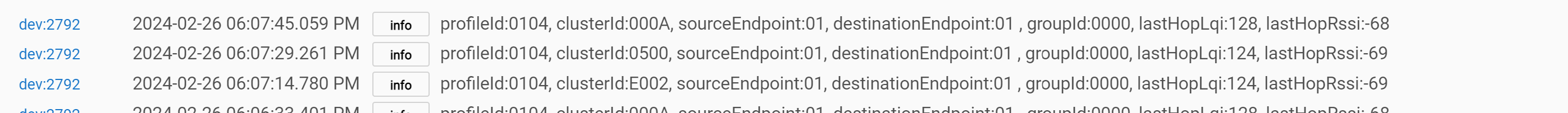

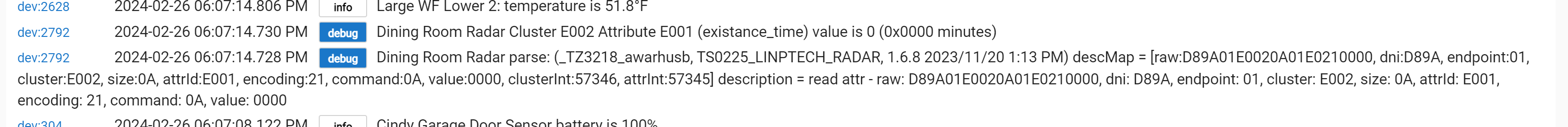

anyway much better than the previous in terms of zigbee traffic about 3 messages per minute when not in the room (instead of 2 per 5 sec)
off the 3
1 is the I am alive message
1 is a bogus no motion report.. not sure why they need that every minute.. i am alive shoudl be enough.
the third i am not sure what it is maybe @kkossev can chime in. nothing comes out with debugging on and i would have to modify the driver to get to the bottom of it..

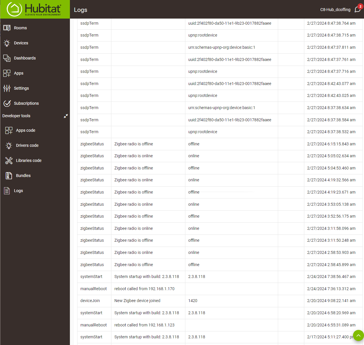

Good to know. It seems your is similar to mine but you haven't had any Zigbee radio OFFLINE incidents yet with only 3 of the devices.

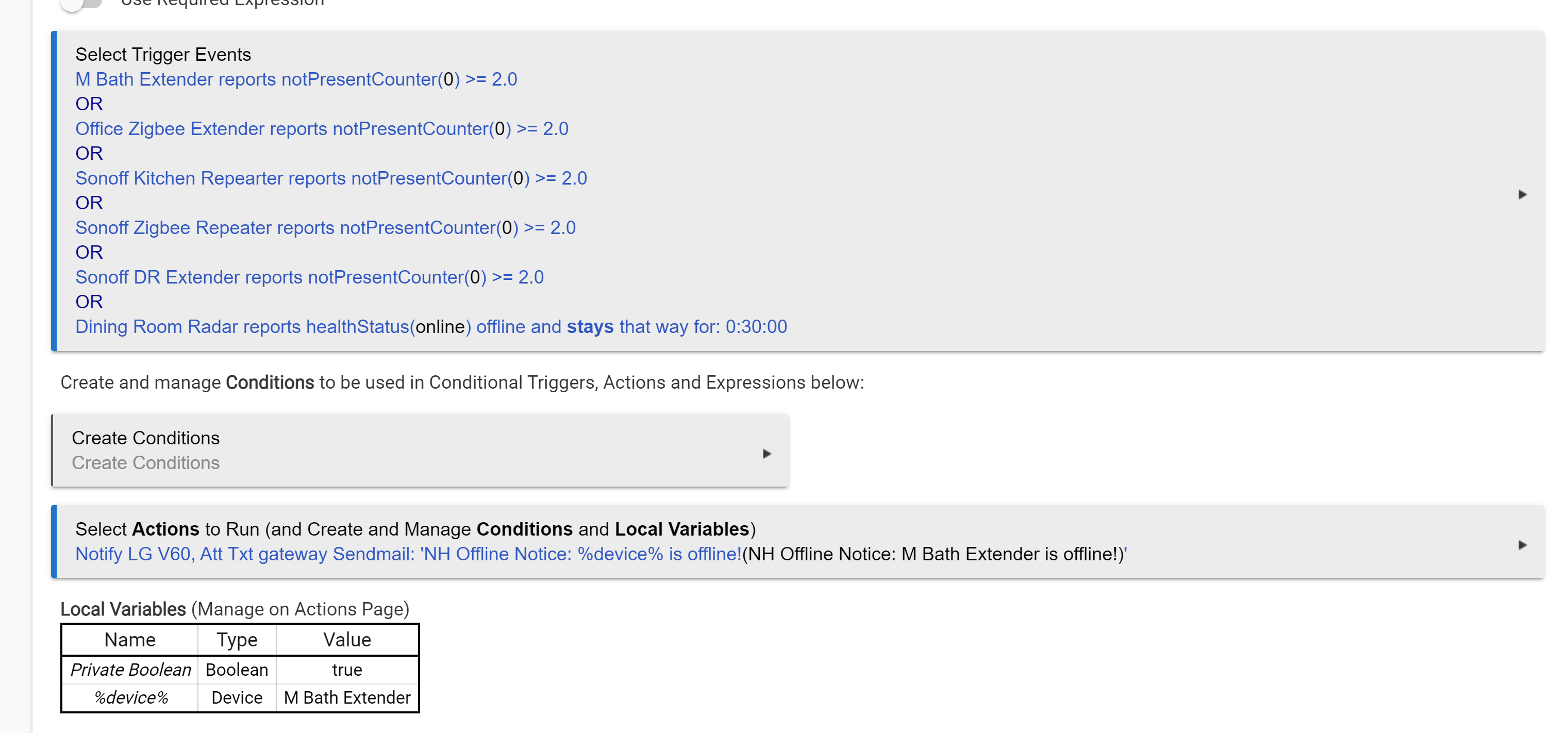

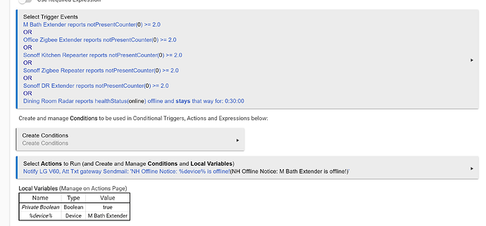

added it to my zigbee externder offline rule..
ie

Mine was after 36 hours since the last reboot. How many hours was your hub running when you posted the details?
I don't remember exactly but it was only a few days max if even that. Today I am down again and requiring another reboot. I need to move up the priority of moving these spammy devices over to another spare C7 hub
