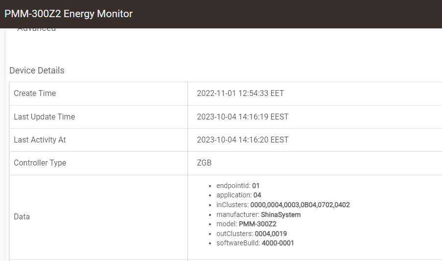

So it all depends on the particular device - what is yours? (model/manufacturer).

- endpointId: 01
- application: 70
- inClusters: 0000,0006,0003,0004,0005,1000,000A,E001,E000,0702,0B04
- manufacturer: _TZ3000_okaz9tjs
- model: TS011F
- softwareBuild: 0122052017

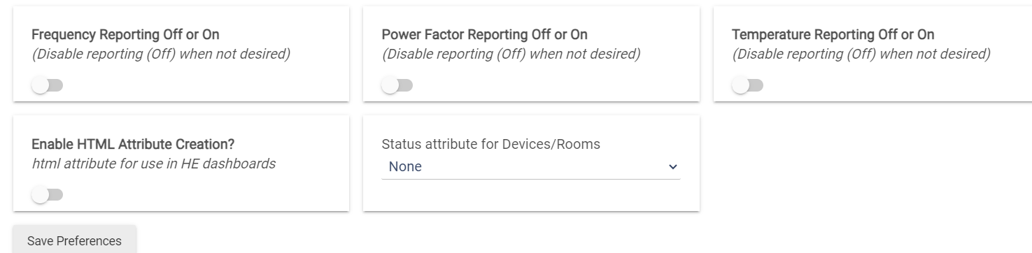

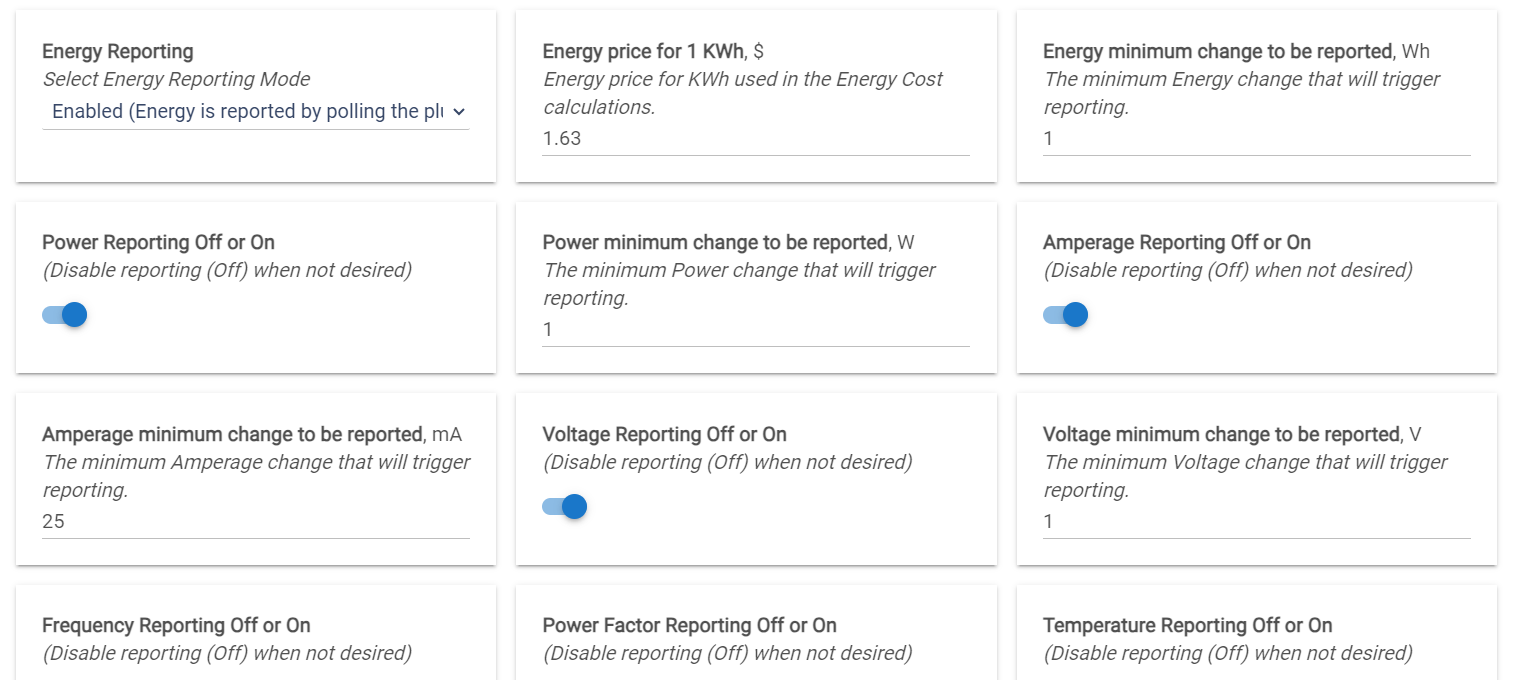

Is the 'Reset Energy' button working?
Make a screenshot of all the Preferences.

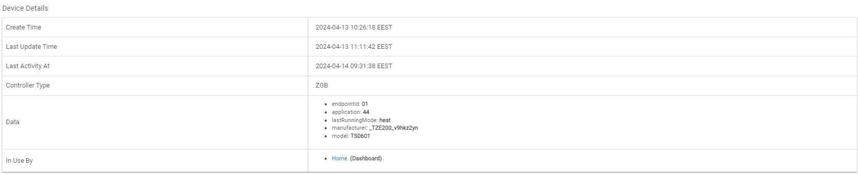

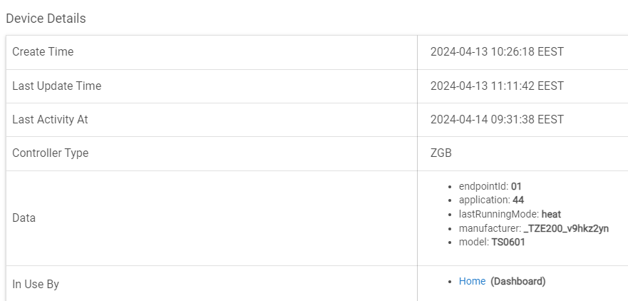

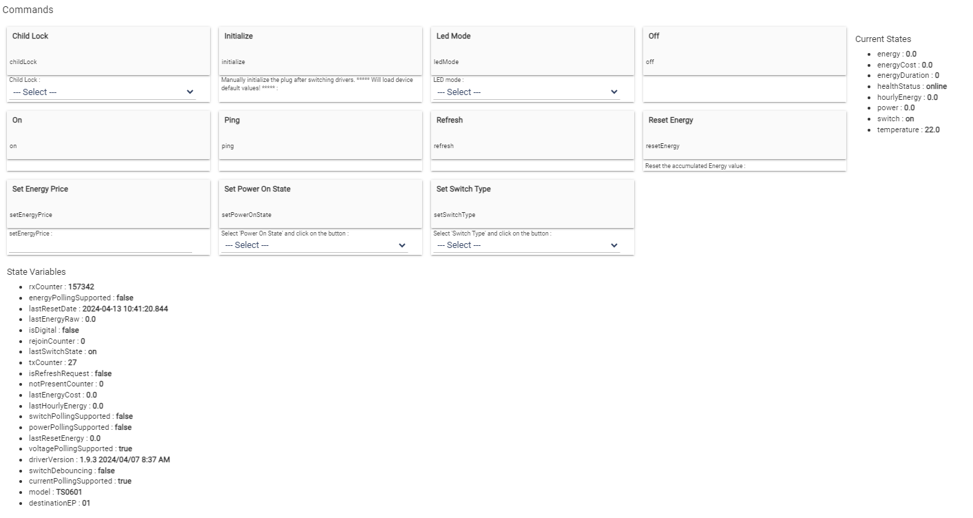

What is the three-channel power meter model and manufacturer? (Post a screenshot off the Device Details section )
TS0601 _TZE200_v9hkz2yn is a new device, still not supported in Home Assistant / Z2M.
Seems similar to this one, but the manufacturer is different.
Looks exactly like the one in your link

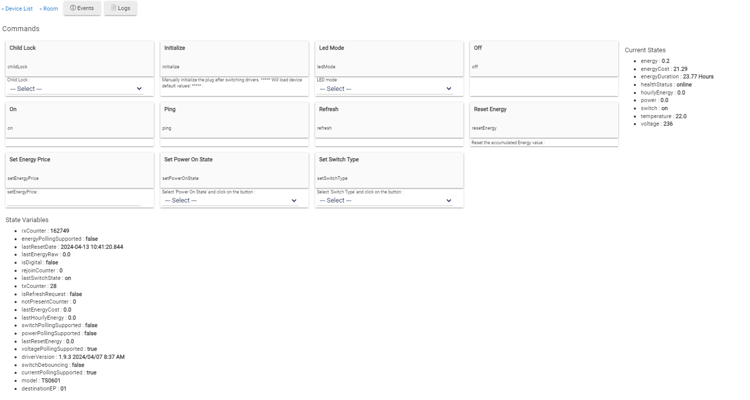

Try version '1.9.4' '2024/04/14 10:11 AM' (dev. branch)
Only the first channel - will it show meaningful voltage/amperage/power ?
Do you have any load? The power readings on the screenshot is zero?
States with load
