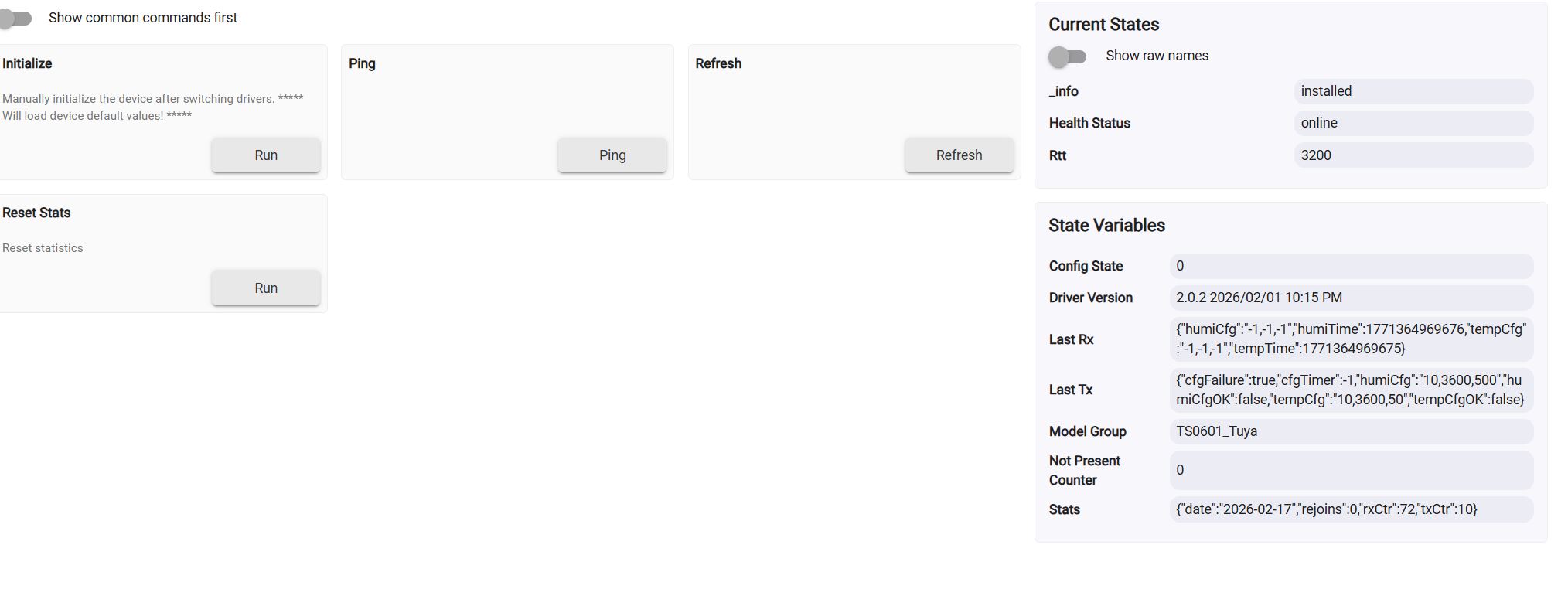

Hi Kossev, I've also recently received one of these (_TZE284_hodyryli) and see that they're not added to your incredible driver list.
The model group of this device is discovered as 'Auto' and reports Time, Humidity and just the local Temperature (the display temp sensor) . The External Temp. sensor is not detected etc.
Can I ask if there is a possibility of you working your magic on this device as having the dual temp sensors is a very useful capability.
FYI: I reached out to @michaelahess, who generously told me that he has managed to get the 2nd sensor being displayed and available in Hubitat BUT he's achieved it by using the Tuya IoT Platform (Cloud) Hubitat app & drivers. Unfortunately I'm using a c7 so that method is not available to me.
Hi Nic,
Please manually update the driver to version ver. 2.1.0 2026-03-31 2026/03/31 7:38 AM :
  • (dev. branch) added TS0601 _TZE284_hodyryli Tuya Temperature Humidity Sensor with External Probe into a new 'TS0601_ZTH03PRO' group, using child device for the probe @njanda
Click on the Initialize() button - it should automatically assign this device to a new a new 'TS0601_ZTH03PRO' group and must create a child device, using HE inbuilt 'Generic Component Temperature Sensor' driver :
Let me know if it works.

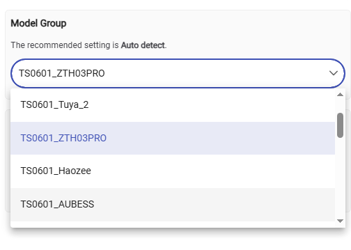

Hi Krassimir,
Thanks for having a crack at this display with external sensor.
The 'v2.1 dev branch' driver code was copied across and when enabled it displays the expected data from the main display (nice !) and creates the Child device however the Temp is displayed as 20 and does not change. On the actual display the external sensor was showing as 33.5c
The modelGroup was left as 'AUTO' and shows the selection you indicated 'TS0601_ZTH03PRO'
I don't know why 'illuminance' is showing as I don't think this device has that capability.

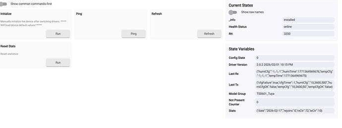

Current States
Show raw names
battery 100
healthStatus online
humidity 70
illuminance 0
temperature 26.7
State Variables
configState 0
driverVersion 2.1.0 2026/03/31 7:38 AM
lastRx {"humiCfg":"-1,-1,-1","humiTime":1775736605126,"tempCfg":"-1,-1,-1","tempTime":1775736604849}
lastTx {"cfgFailure":false,"cfgTimer":0,"humiCfg":"-1,-1,-1","humiCfgOK":false,"tempCfg":"-1,-1,-1","tempCfgOK":false}
modelGroup TS0601_ZTH03PRO
notPresentCounter 0
stats {"battCtr":7,"date":"2026-04-09","humiCtr":7,"rejoins":0,"rxCtr":41,"tempCtr":7,"txCtr":4}

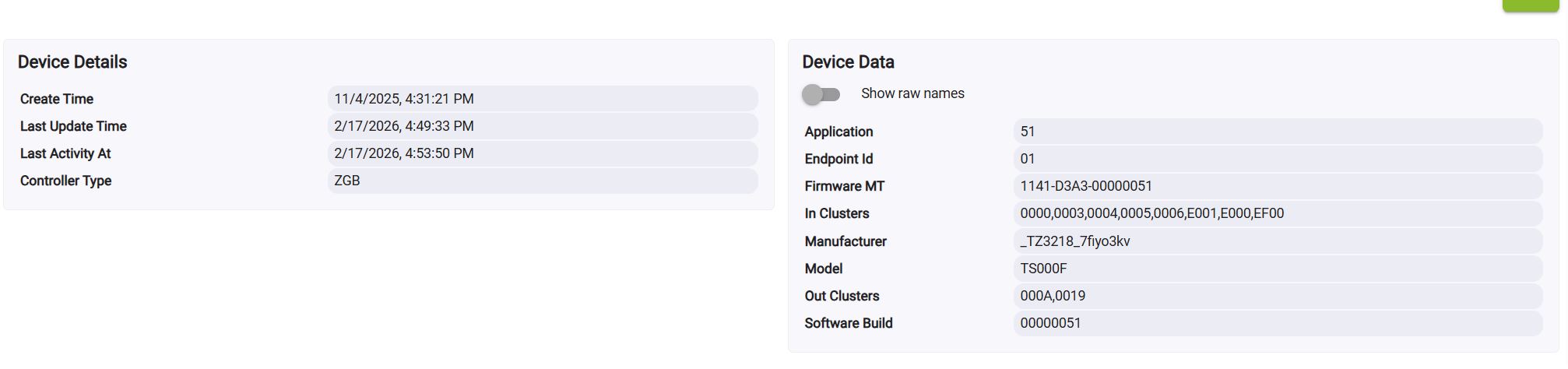

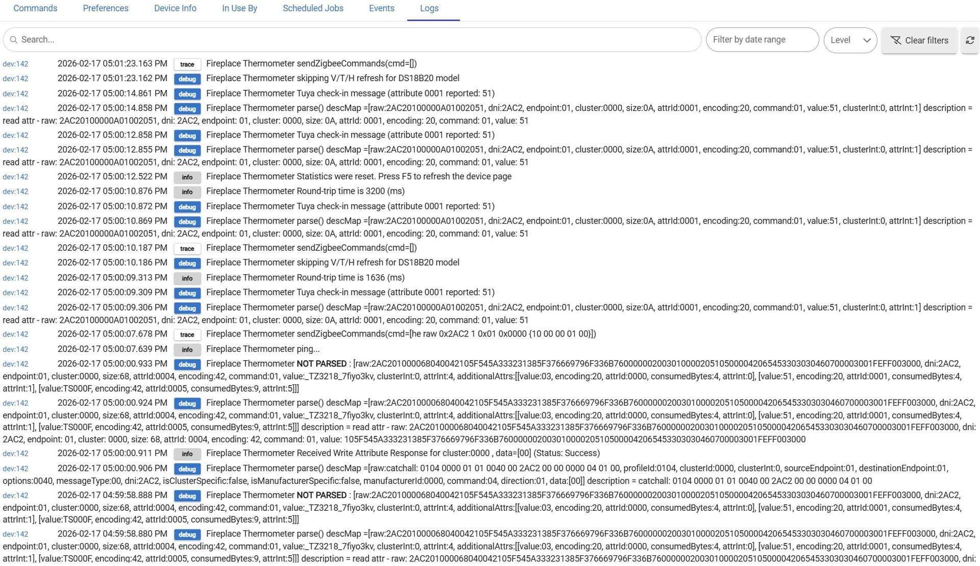

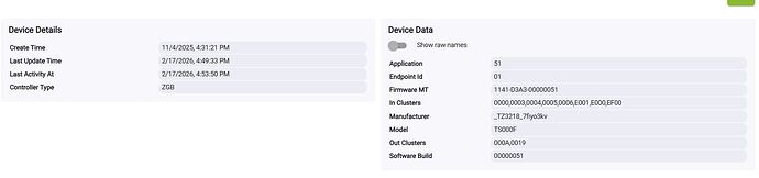

I am hoping someone can help me with a new sensor. I recently received a couple ZigBee Smart Temperature and Humidity Sensor RSH-HS03. I added one to my Hubitat C8 Pro, but have not been able to get temperature/humidity data using any of the drivers.
I am attempting to use the Tuya Temperature Humidity Illuminance LCD Display with a Clock (ver. 2.0.2) driver, but it is still not working. Any recommendations/assistance would be greatly appreciated.
For reference, here is the Device Data and State Variables I am receiving:
Device Data
Application: 50
Endpoint Id: 01
Manufacturer: _TZE284_9ern5sfh
Model: TS0601
State Variables
Config State: 0
Driver Version: 2.0.2 2026/02/01 10:15 PM
Last Rx: {"tempTime":1776123562893,"humiTime":1776123562893,"tempCfg":"-1,-1,-1","humiCfg":"-1,-1,-1"}
Last Tx: {"cfgFailure":false,"cfgTimer":0,"humiCfg":"-1,-1,-1","humiCfgOK":false,"tempCfg":"-1,-1,-1","tempCfgOK":false}
Model Group: UNKNOWN
Not Present Counter: 0
Stats: {"date":"2026-04-13","rejoins":0,"rxCtr":0,"txCtr":2}
Updated the development branch to ver. 2.1.1 2026-04-14
  • added support for four switch child devices for _TZ3218_ya5d6wth @pauljneil2 ;
  • added TS0601 _TZE284_9ern5sfh @rlynch into a new group TS0601_Tuya_3
@njanda I will need some debug logs, shown when you rapidly change the temperature of the external probe.
@rlynch after updating the driver, obligatory pair the sensor once again to your hub (without deleting it).
