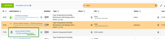

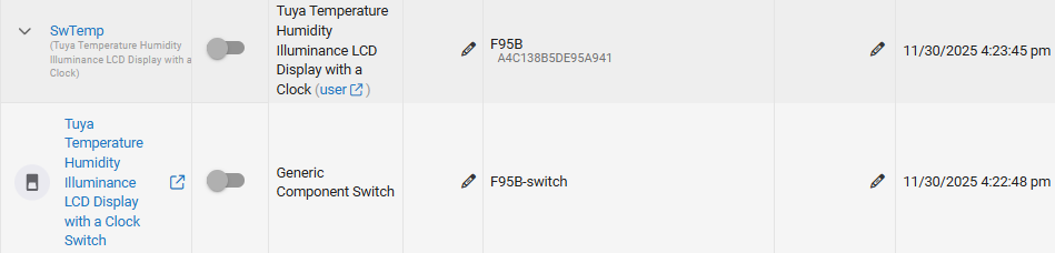

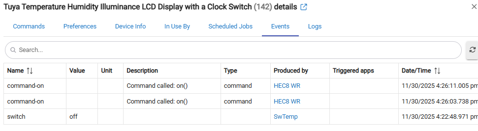

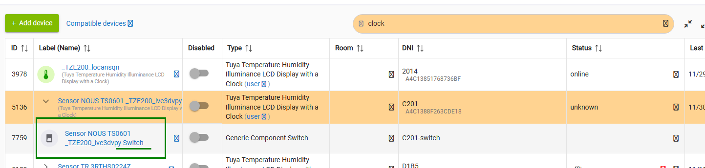

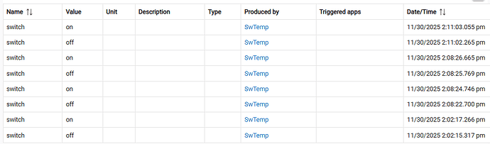

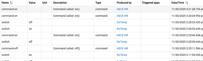

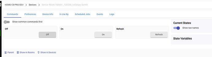

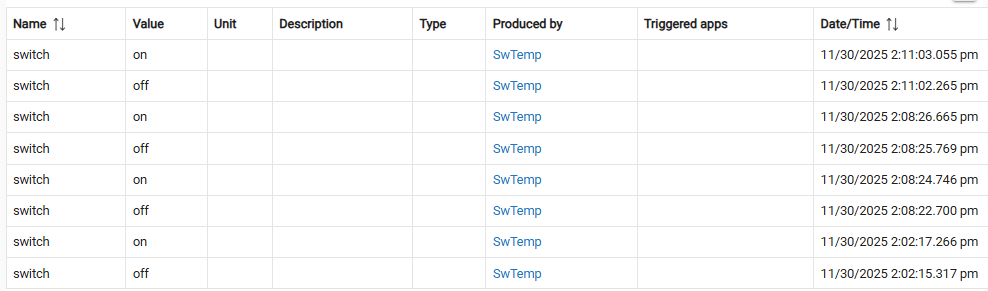

Hi, kkossev
The switch seems to be working well. Thank you.
Summary
dev:1322025-11-30 02:11:19.653 PM
info
SwTemp temperature is 18.6 °C
dev:1322025-11-30 02:11:19.648 PM
trace
SwTemp dp_id=2 dp=102 fncmd=186 fncmd_len=4 (index=0)
dev:1322025-11-30 02:11:19.640 PM
debug
SwTemp parse() descMap =[raw:catchall: 0104 EF00 01 01 0040 00 4A6A 01 00 0000 06 01 100166020004000000BA, profileId:0104, clusterId:EF00, clusterInt:61184, sourceEndpoint:01, destinationEndpoint:01, options:0040, messageType:00, dni:4A6A, isClusterSpecific:true, isManufacturerSpecific:false, manufacturerId:0000, command:06, direction:01, data:[10, 01, 66, 02, 00, 04, 00, 00, 00, BA]] description = catchall: 0104 EF00 01 01 0040 00 4A6A 01 00 0000 06 01 100166020004000000BA
dev:1322025-11-30 02:11:03.300 PM
debug
SwTemp DS18B20 Switch is already on, skipping duplicate update
dev:1322025-11-30 02:11:03.294 PM
debug
SwTemp parse() descMap =[raw:4A6A0100060800001001, dni:4A6A, endpoint:01, cluster:0006, size:08, attrId:0000, encoding:10, command:0A, value:01, clusterInt:6, attrInt:0] description = read attr - raw: 4A6A0100060800001001, dni: 4A6A, endpoint: 01, cluster: 0006, size: 08, attrId: 0000, encoding: 10, command: 0A, value: 01

It reflects the switch's signal well, but it cannot be operated on the dashboard.
How was the switch activated and deactivated? Was it controlled by the child device commands or by a physical button on the device?
The switch is controlled by the physical button and reflected well on the dashboard.
However, if you issue commands from the dashboard, the physical switch does not work.
Summary

Lets forget about dashboards for a moment. My question is can you control the switch from the child device, that is created by the driver? The child switch virtual device is shown under the main device that uses this driver:
The child device has two commands On and Off, and also a Refresh button :
Can you control the switch from these On/Off buttons from the device web page?
It seems to be working... EDIT: I don't see the switch on / switch off events :frowning:
So is the relay controlled from here, or not?
Is this the child device that you are trying to control from a HE dashboard? Which dashboard - the 'classic' or the new EZ dashboard?
I deleted the device and then paired it again, but the result is the same.
Summary
consumedBytes:4, attrInt:0], [value:51, encoding:20, attrId:0001, consumedBytes:4, attrInt:1], [value:TS000F, encoding:42, attrId:0005, consumedBytes:9, attrInt:5]]]

There is no need to initialize or re-pair the device ...
Just click on the virtual child device 'On' or 'Off' commands from the device web page - does it work?
It won't work.

Thank you - these are the logs that I was looking for.
OK, update the driver again - timeStamp '2025/11/30 9:57 AM' ( updated a few minutes later to switch the DEBUg functions off)
In this version I am using the standard ZCL commands for controlling the switch on and off, this device seems to be a hybrid between standard and Tuya-specific Zigbee commands ,,,,
It works perfectly.
You did a great job, kkossev
