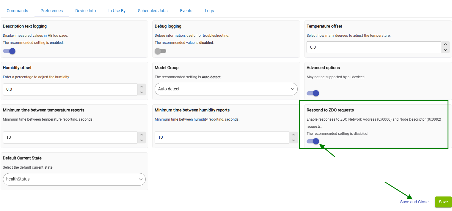

@rlynch I see a possible Zigbee rejoin / discovery issue in the logs :
dev:3152026-04-14 04:32:15.063 PMdebugBedroom temp sensor ZDO Node Descriptor response disabled by preference
dev:3152026-04-14 04:32:15.062 PMdebugBedroom temp sensor ZDO Node Descriptor request, data=[98, 00, 00] (Sequence Number:98)
dev:3152026-04-14 04:32:15.046 PMdebugBedroom temp sensor parse() descMap =[raw:catchall: 0000 0002 00 00 0040 00 A8A7 00 00 0000 00 00 980000, profileId:0000, clusterId:0002, clusterInt:2, sourceEndpoint:00, destinationEndpoint:00, options:0040, messageType:00, dni:A8A7, isClusterSpecific:false, isManufacturerSpecific:false, manufacturerId:0000, command:00, direction:00, data:[98, 00, 00]] description = catchall: 0000 0002 00 00 0040 00 A8A7 00 00 0000 00 00 980000
Try the following :
  • in the Preferences tab, enable the 'Advanced Options'
  • enable the "Respond to ZDO requests."
  • save and close
  • do NOT delete the device
  • pair it again to your C-8 Pro hub, at a close distance.
If no temperature readings again, check whether the device remains connected: remove the batteries and wait 30 seconds before reinserting them. With the Debug preference enabled, you should see log entries indicating that the device is automatically reconnecting to the Zigbee network.
You can also try using the Double Luck voodoo to pair the device again.

Nic - thank you for the logs, they are very useful and now I see where the problem is in the driver code. The fix is coming in the next build.
Can you please edit your post and delete the long logs? I have copied them, thanks!
Thank you kkossev !!
The ZDO request change did not make a difference. However, I tried the Double Luck Voodoo process and both devices are now working.

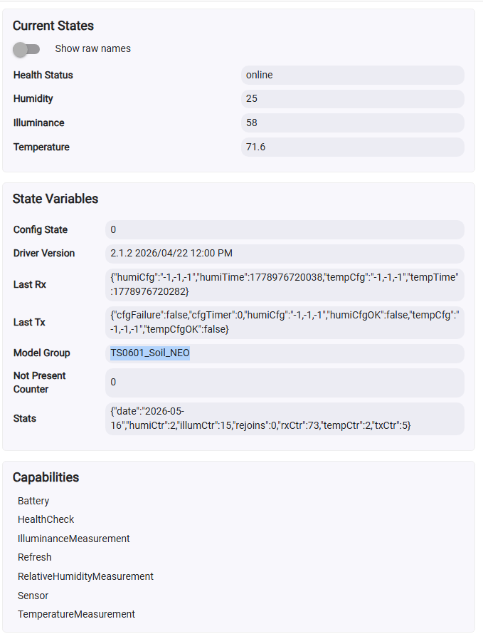

ver. 2.1.2 2026-04-22 :
  • added COOLO CS-201Z _TZE200_npj9bug3 _TZE200_wrmhp6b3 into new 'TS0601_Soil_Coolo' group;
  • added soilMoisture attribute

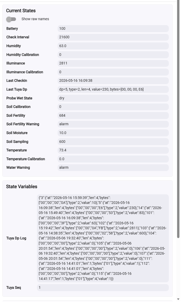

5 In 1 Zigbee Soil Tester Moisture Fertility Temperature Humidity Luminance Detection Sensor For Z2MQTT Tuya Smart Life Optional - AliExpress 1420
I am using a bunch of these sensors, I asked ChatGPT to create a device driver for me to obtain all the values based on a zigbee2mqtt driver, I am able to get fertility value along with moisture humidity and all but devices stop reporting after few minutes when i use that code, using your device driver and selecting TS0601_Soil_NEO only gives me temp, humidity and illumin. Any idea how can i get all values, Attached are some screenshots and drivercode from chatgpt
https://codeshare.io/aYY3p3

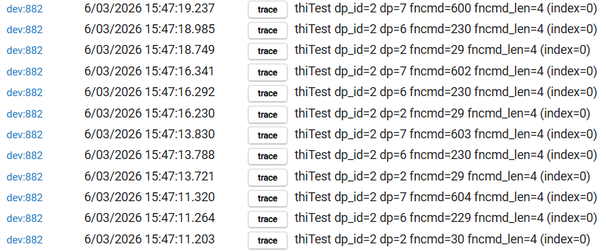

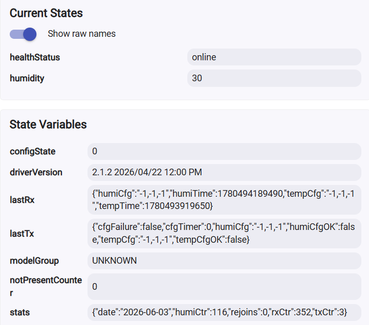

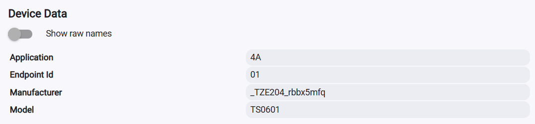

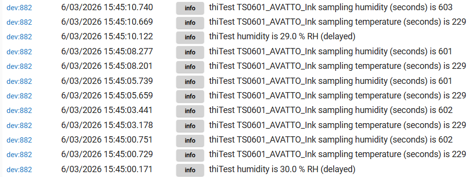

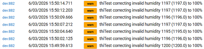

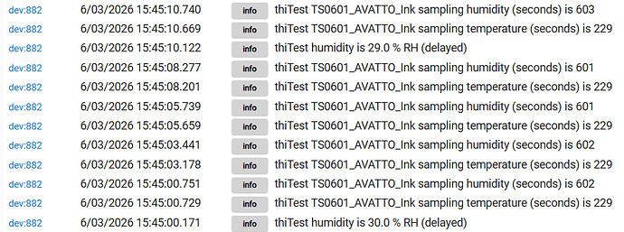

I tried your wonderful driver to integrate this device:
But it shows only (half of the real) humidity:
The info logs are indicating that at least values for humidity and temperature are arriving:
IMHO those values have to be divided by 10 to get the real values.

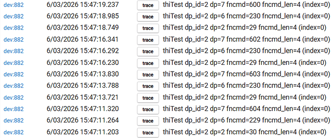

BTW: The trace logs are showing values for three different value types (dp=2 for illuminance, dp=6 for temperature, and dp=7 for humidity):
FYI: And those are examples for the debug logs:

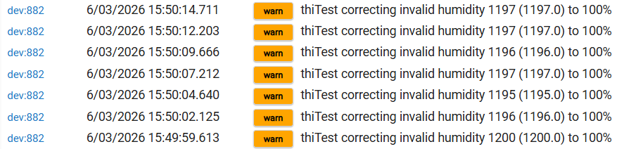

When I put the device under bright light I get warn logs like this:
It seems that the driver isn’t using the right relation between values and their types…
Please: What can I do to fix this? :thinking:
Hi Jost,
This is a new device that is unknown in this driver... that's why the humidity scaling is wrong. I will try to add it in a future update, but can't promise a date, there are already too many pending TODOs in my list...
Meanwhile, you can try to use AI to create a modified version of this driver for your own use for this particular device.

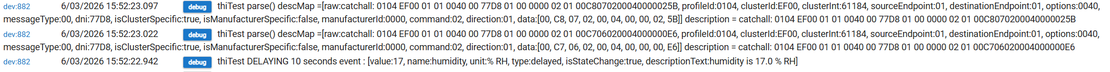

Done! :+1:
Only “problem”: The Zigbee messages of this device are incoming much to often; Do you (or someone else) know a way to slow it down? (I’m not talking about reducing the events the driver is firing - that’s already working.)
I fear “my” device is using other DPs for configuration - if any? :thinking:
