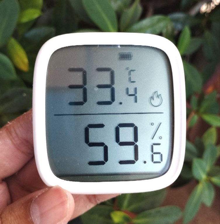

I just picked up a pair of Sonoff SNZB-02D from Amazon. I've noticed that there was this black bar at the bottom of the display which I don't see in the pics above or the pics elsewhere. I'm curious if there's a defect in the display.
This is what mine looks like
This is what it shows in the ads and mostly on Google images
images
Normal. I have 2 that look like that.
Thank you for confirming.
