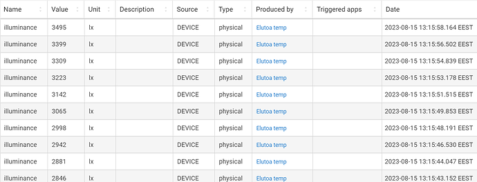

This device is problematic, but shouldn't send illuminance updates so frequently.. And the illuminance values are incorrect, too high.

Everytime brightness (lux) changes, it sends data. Battery was depleted in 6 months.

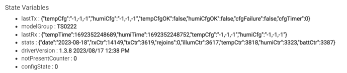

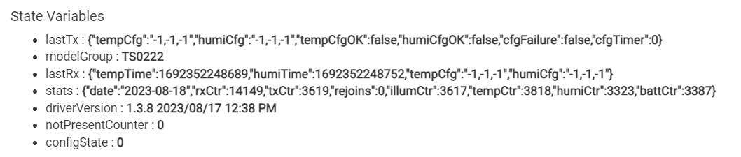

Can you post a screenshot of the 'State Variables' section?
The Lux readings are unusually high... Where is the device placed - indoor or outdoor?
Device is placed indoor but sun shines on it when the value is that high.
