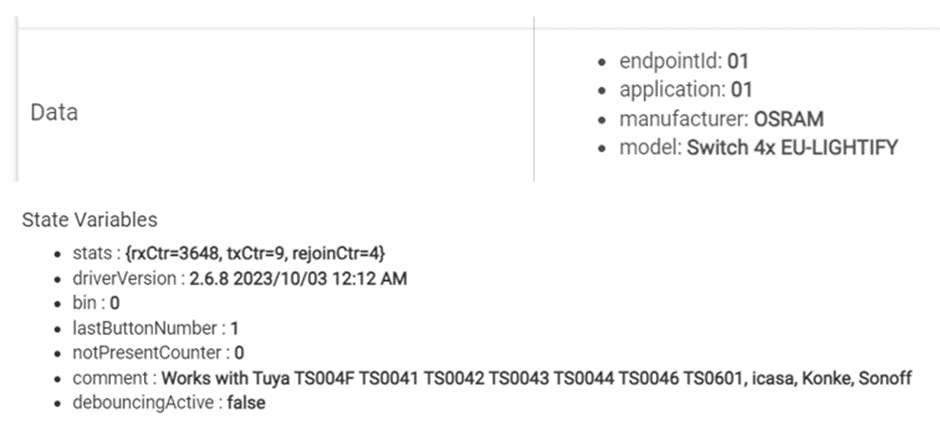

@kkossev,
I can confirm that I have the same button controller and experiencing delayed response to button presses. Disabling denouncing seems to fix the issue.
1 sec denouncing on another controller, Lightify, seems to be unaffected.
Moes 4 button controller - delayed response
Lightify controller - unaffected
EDIT: Had to disable debouncing on the Lightify controller as the controller stopped responding.
