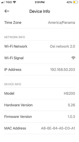

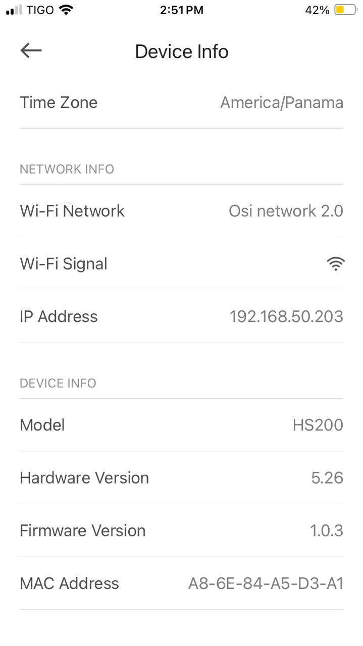

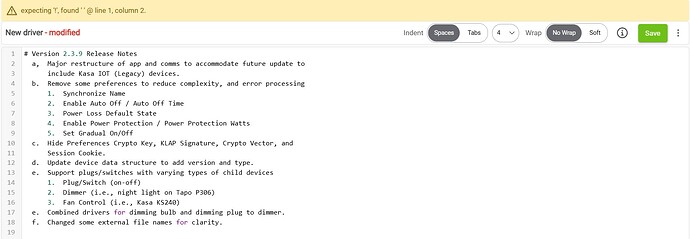

Hi, I need some help to get an HS200 integrated.
I already had 6 legacy HS200 which work 100% but one of them died. I decided to get another one, found out the new one has a newer hardware and after investigating a little bit I found out I had to use Tapo integration for the new switches however I keep getting an error when I'm trying to add the device to my hubitat. The device works as intended through the KASA app.
Tapo integration log page:
HS200 Device information:
Did you install the driver for the HS200? It would be TpLink Plug.
No I didn't. Got it working now thank you very much!
I think you are trying to install the installation instructions as a driver. That's where the error is originating from.
I would recommend installing this using Hubitat Package Manager (HPM). You can install HPM using the instructions in this post:
