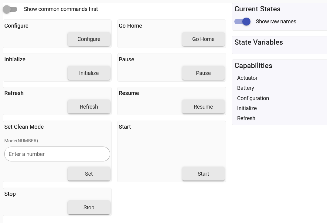

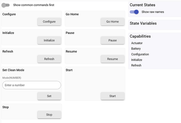

Tapo RV20 and RV30 Robovac news.
These devices are now Matter capable for basic control (cleaning mode, on/off/pause/home). The Matter instance does not support Map area selection for cleaning. Due to this, I have ceased trying to add the very complex TPAP protocol (these vacuums are the only users) to this code base.
Install is direct into Hubitat from the Tapo Phone App
Install Vacuum into Tapo Phone App
In setting, select the Matter Code section. This will display the code.
In Hubitat, select install mater and enter the code above.
It will install as a generic device. Change this to Generic RVC.
