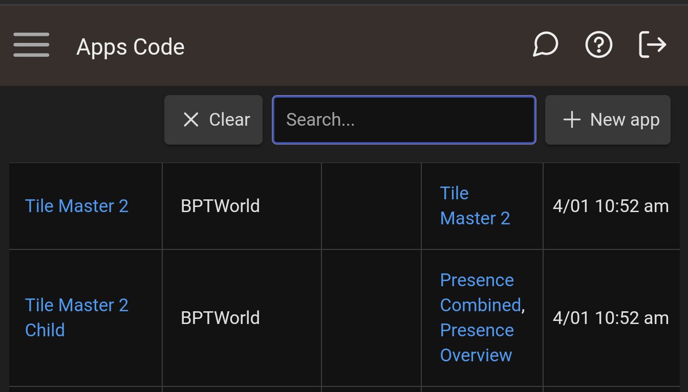

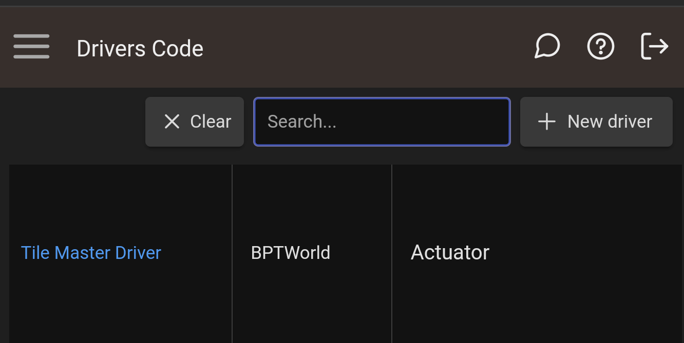

so i have tried this already. It seems the driver is installed but the parent/child apps are not.
I then tried manually importing the parent/child and found that:
importUrl: "https://raw.githubusercontent.com/bptworld/Hubitat/master/Apps/Tile%20Master/TM2-parent.groovy",
in BPTWorld.TileMaster2.groovy does not seem to exist. can someone help me out with this?

You need the Drivers and Apps before you will see them in the User App to add.
From the Zip:
  • Copy Raw BPTWorld.TileMasterDriver.groovy into Drivers Code - I believe you have
  • Copy Raw BPTWorld.TileMaster2.groovy into Apps Code - this is the Parent
  • Copy Raw BPTWorld.TileMaster2Child.groovy into Apps Code - this is the Child
** If you copied the Parent and Child into Drivers Code, delete those.
Once those 3 are individually created in the right area, you should be able to Install the User App successfully.

okay!! i was missing the library!.
now i was able to properly add the parent/child codes in!
thanks @DenverTech99 @bptworld
