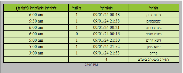

I would like to get a tile presenting all my valves and for each one present the last_watering_duration, last_watering_date and the device label.
Problem is - when using the Device Group opition all of the device attributes are not available in the Variable field to choose from:
Am I doing something wrong?
BTW, I could find them in the Free From option but I could not find a way to assign more than one device to a form.
Thanks for reaching out.
Yes, when using a Device Group is only lists "known" capabilities and attributes as defined in the driver capability list. Driver Capability List | Hubitat Documentation
I did anticipate your situation but I thought it was handled well enough by the Free Form mode as I will explain.
I believe you have encountered a bug that was reported last week (not yet fixed) whereby if you start with a Device Group, make some changes and switch to Free Form mode you can't add additional variables. So, create a new instance, immediately switch to Free Form mode and you should be able to add up to 40 unique variables. Each of these variables can point to a unique device\attribute.
Because I know the device you are pointing to I can populate the attribute list with the actual attributes listed on the device (not just those typically associated with the capabilities of that device as in Device Group).
That should do the trick but if not let me know. I'll get that bug fixed in the next day or two.
You may find the use of %lastOpen%, %lastClosed%, %lastActivity% (see docs) a useful addition to your table.
Please post a picture when you are done. I don't have any valves so I'm curious to see how it looks.
Thanks @garyjmilne,
This did the trick.
I now have a table with 7 valves and for each I have 3 different attributes beside the valve name.
I also have the rain delay displayed in the last row as it is the same for all valves.
I will now work on the layout to fit my dashboard minimalist design.
Thanks a lot for all your help and efforts. You are a real asset to this great comunity.

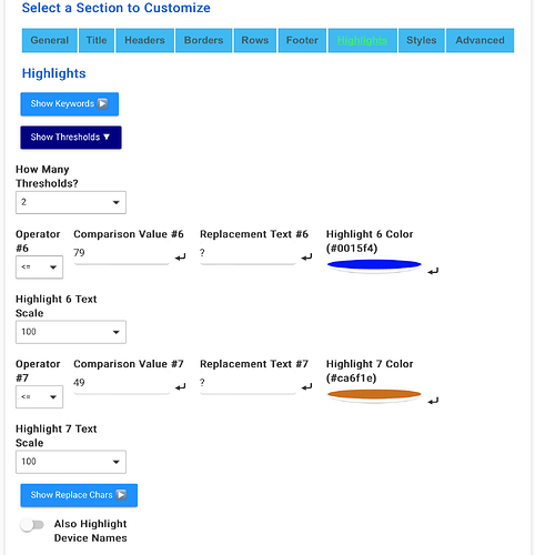

I designed a Battery Load table some time ago (maybe months ago), with 2 threshold values for mid and low values, and it was working great, but a few days ago, (maybe on one of the updates) those thresholds quit working.
Did you change anything? Do you think I did something wrong? (promise I didn´t do it!!).
The last version I see that might account for is is 1.4.0 which was released back in September and dealt with the thresholds.
If you go back into thresholds and verify the setup I expect it would work. It might just need saving.
Here is how I have it set up. Do you see anything wrong?
Besides this, if I select the bottom option, “Also Highlight Device Names “, I will get an error.
I already had rebuilt the tile a few times from scratch.
Yes, I do see something wrong. For the replacement text field you need to enter %value% which tells it to insert the current value.
Please send the error you are getting on the Highlight Device Names.
