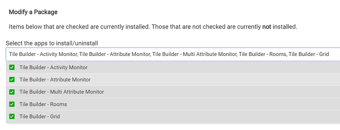

How to Install Grid:
  1. Upgrade your Tile Builder to the current version.
  2. Install Grid by going to HPM and picking "Modify a Package", selecting "Tile Builder" and then making sure that Grid is a selected module as shown below.

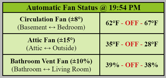

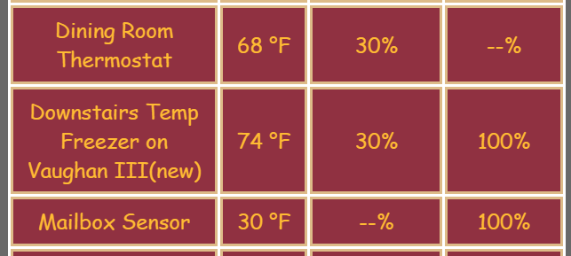

You have seen what Grid can do in some of the earlier posts over the past few weeks so I won't repeat those here, But I do want to emphasize that Grid is not just about adding more columns, it's a whole different way of creating a layout and placement of data is very flexible.
Effectively I have four columns of data placed within a two column table to make the table as small as possible.

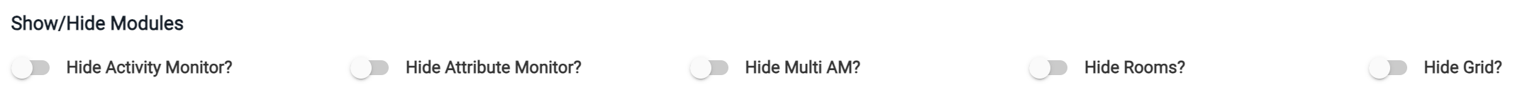

P.S. There is one thing in this update for all users which is the ability to show\hide unused modules on a per instance basis. You can find this in the Parent App under More.

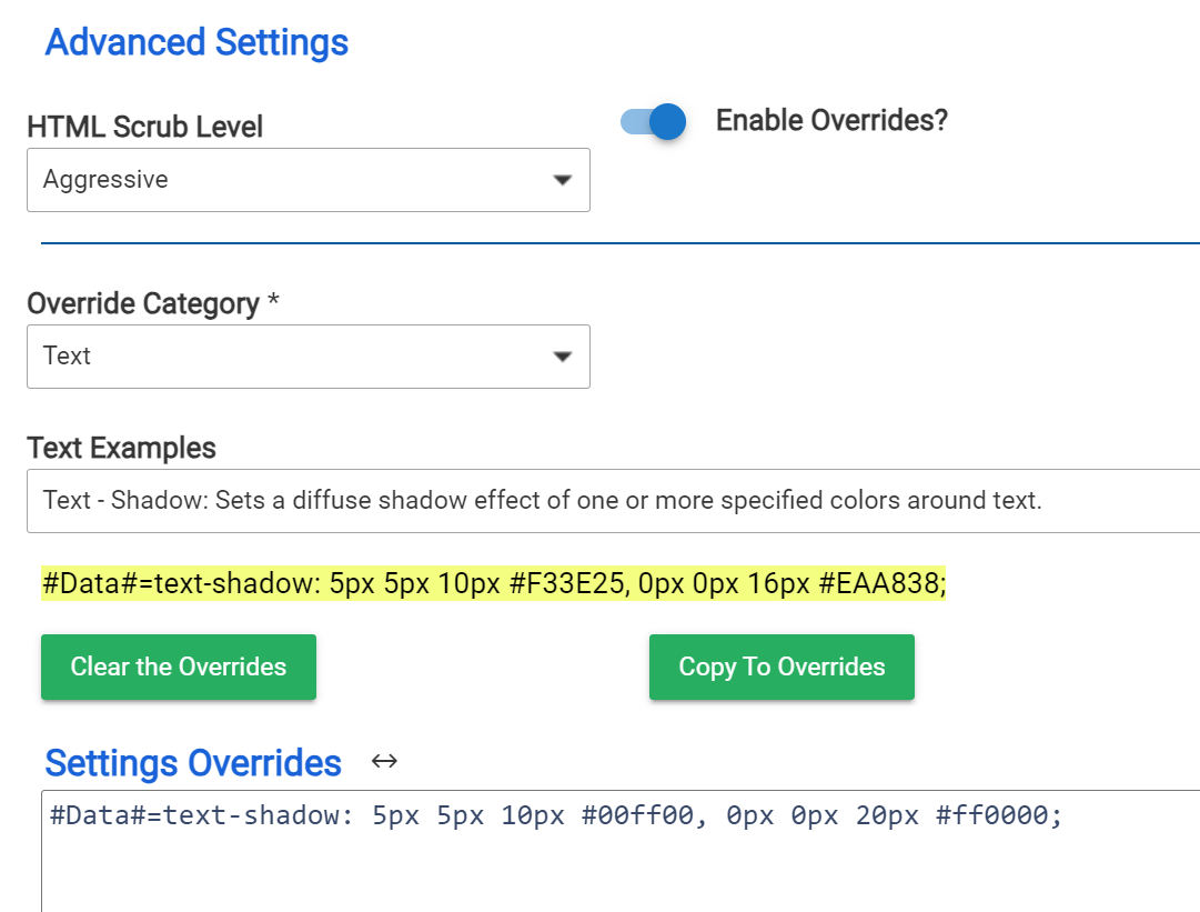

I have noticed shadow text is not available when customizing the table. Can it be added to at least when customizing the Title?
I'm glad you like it. I look forward to seeing some of the tables people produce with Grid.
I took it out of the UI because it's a relatively obscure feature that used 5 controls and only applied to the Title. It is still available in the overrides section as shown below.
This way people can apply multiple shadows and direct it at any part of the table without having to duplicate the controls on each tab. For your purposes you would use #Title#=text-shadow...... for example.
See here for parameters and examples:

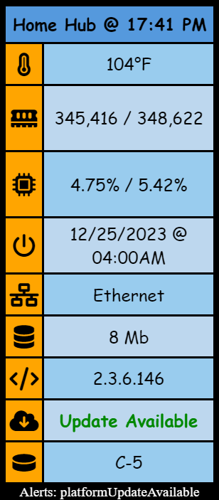

I redid my Hub Info tile using Grid and thought I would share.
I'm using free Font-Awesome icons as a web font for the icons. Takes up more space than plain text titles or eMojis' but I like the look of it. I'll write up a few examples and add them to the Grid Documentation. You could do it in any Tile Builder module but the large text input fields in Grid make it a lot easier.
Comes in at 1,362 bytes which includes a couple of tooltips but it's a tile I'll only look at when I'm on the LAN.

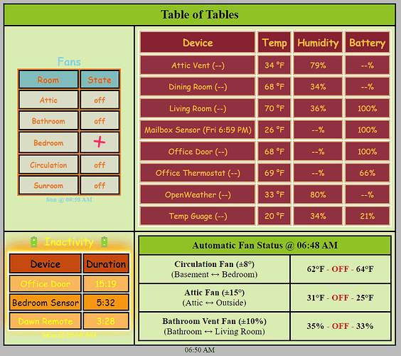

Something else that may be of interest using Grid. Not sure how I would use it but it's fun to experiment. Just point one of the variables to the table of interest in the Tile Builder Storage Device to embed it within another table.

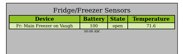

I also would like some help.
Perhaps a simple example would help with the Grid layout.

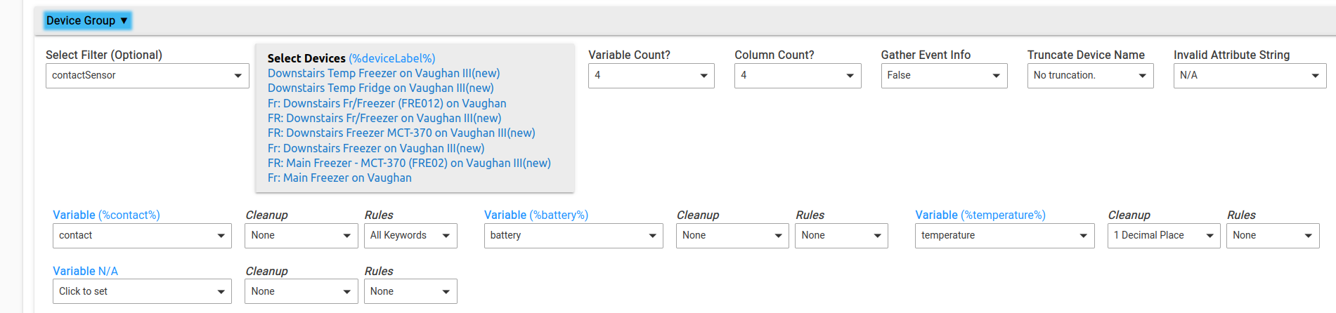

I have a number of contact sensors.
For each contact sensor, I want to report: battery%, state (open/close), and temperature.

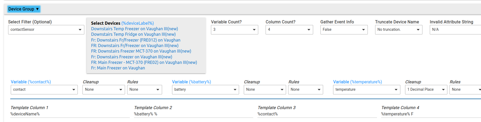

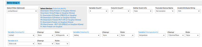

Ok. I got it. However, for some reason, it only puts out the very last sensor of the sensors I put in the device list:

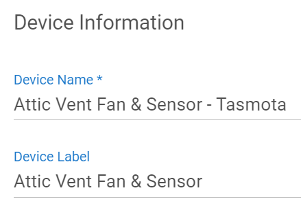

Also, in the device list, should that be %deviceName% not %deviceLabel%?
Could you share a bit more of your configuration, especially the Layout Mode and Device Group sections.
Definitely the Device Label but if you want to use the device name instead you can use %deviceName% in a text field when using a Device Group.
Device Group:
Layout Mode:
I suspect the function that shortens the device names doesn't like the () because those characters have a special meaning. Try setting it to not truncate the device name and see what happens.
I have updated the Tile Builder Grid Help to include the use of Font Awesome icons. You can find it here.

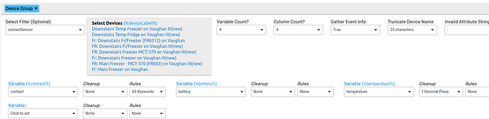

No truncation - made no difference.
Yes, the name does not appear to be the issue as it works for me. Have a look in the logs and see if you are seeing any errors.
Also, try two other things.
  1. Remove the empty variable by reducing the Variable count to 3.
  2. Try changing the Rules for "contact" to None, just as a troubleshooting step. If that does make a difference send me a picture of your Keyword rule.
#1 and #2 made no difference:
No keyword rules.
Nothing in the logs.
In the event of anyone reading this the above turned out to be because the device labels were blank (null) so those devices would not show up.
I've added some logic to handle this and it will be in version 1.0.1.

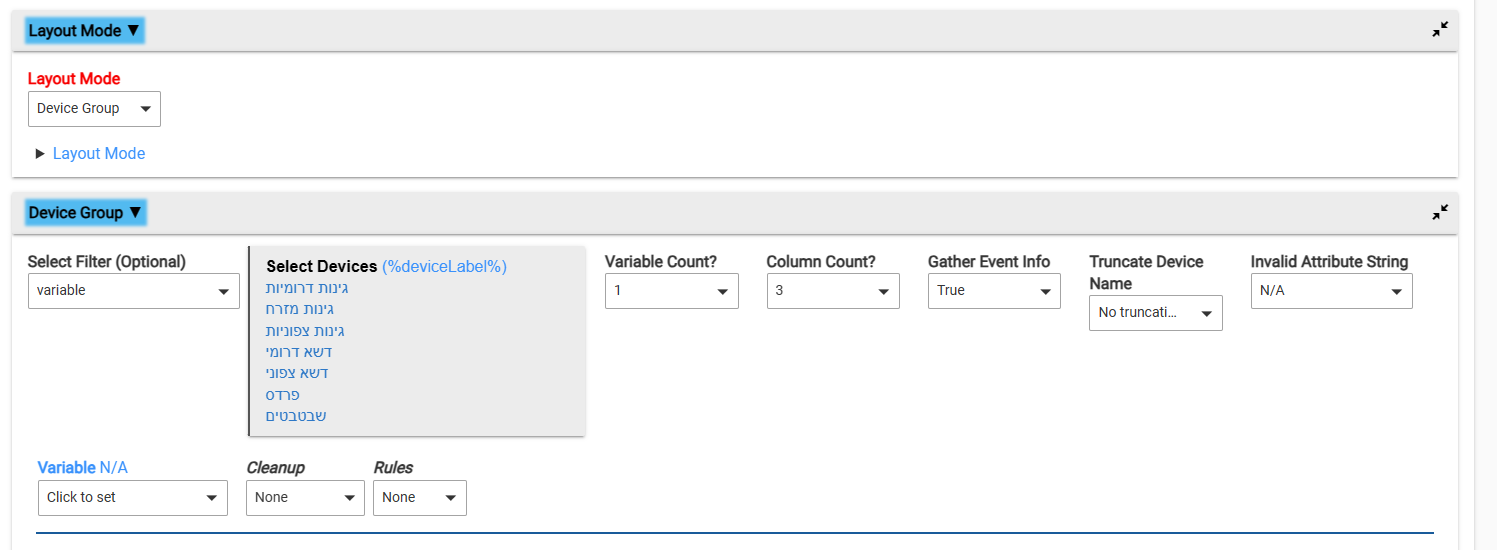

Hi @garyjmilne ,
I ran some tests trying to use Grid to gother information from Hub variables.
These variables basically collect time specific devices (valves) were OPEN in the last day.
I can up with this configuration:
Summary
The tile looks like this:
Summary
Problems:
  1. the tile does not seem to update when (any of) the variable in updated. It onky updates when I go to the app page and click Publish and Subscribe
  2. How can I ommit the "variable" text showing with the variable value?
  3. Is there a way to change the date format so for example "2023-12-29 07:29:13 " will be presented as "29/12/23 - 07:29"?
