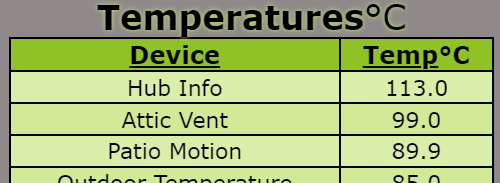

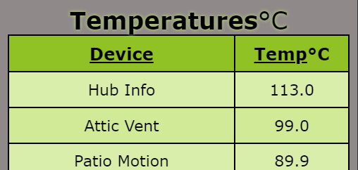

Row height is automatic based on text size and padding. If borders are on then border padding takes precedences. If borders are off then text padding on the rows takes effect.
Border Padding 0
Border Padding 8
Let me know if that helps at all. If not send me a screen shot of the table in question. It can probably be done with overrides.
