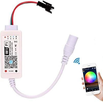

They do have addressable LED controllers. This is the one I have

Also, the one you linked to only supports RGB leds not RGBW or RGBWW. Have you tried the tasmota firmware with that device you linked to and this driver? I'd never seen WS2812's that run off 12v before either. All the ones I'd looked at before were always 5v.
The one I linked to does 12 and 24v addressable LED's. I'm using it with WS2811's There are also other controllers that will work with the RGBW and RGBWW that I have see before. I have not had the opportunity to flash mine but it is running on an 8266 chip so I just need to open it up and flash it. eventually... But since @848667 has flashed his controller with Tasmota and the Tasmota firmware does support the addressable LED's this driver can handle that.
