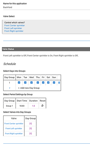

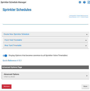

PARENT App:
And CHILD App:

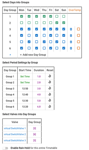

  • merged two Tables into one.

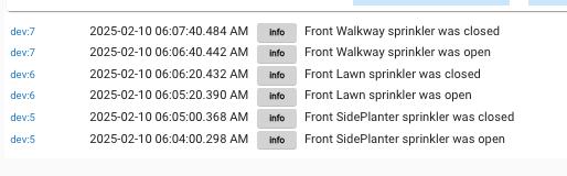

I created several Virtual Valves to test out the app and I think it's a great way to explore without wasting water. :smiley:
Here's my Log from this morning:
Screenshot 2025-02-10 at 12.48.35 PM
The schedule was started at 6:04am and ran for a minute, then there's a 20 second delay for the valve to actually shut. The second valve starts at 6:05:20, and the third at 6:06:40 ending at 6:07:40 for exactly a minute per valve.

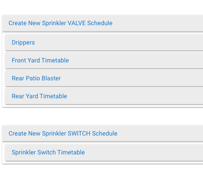

As I said above, the bigger challenge is how to present the option. My first visualization uses a 2nd Child app... one specifically for switches.

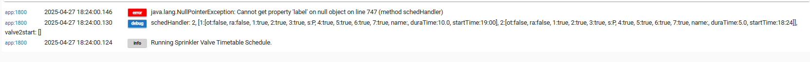

Hey all. Great app!
I have tried it with a Sonoff valve I have.
I am getting this error when the schedule tries to run:
Any ideas?
Valve turns on and off through HE with no issues.
Thanks in advance
it probably means that you don't have a label set on a Valve.
It's looking for device.label and a null is the result. I'll fix it for the next release, but for now, the work around would be to fill in the label.
Odd. It has a label
Is it because there is a space between words?
No, a space wouldn't result in a null.
I've run a test or two with both a blank label and one with spaces and can't duplicate it.
