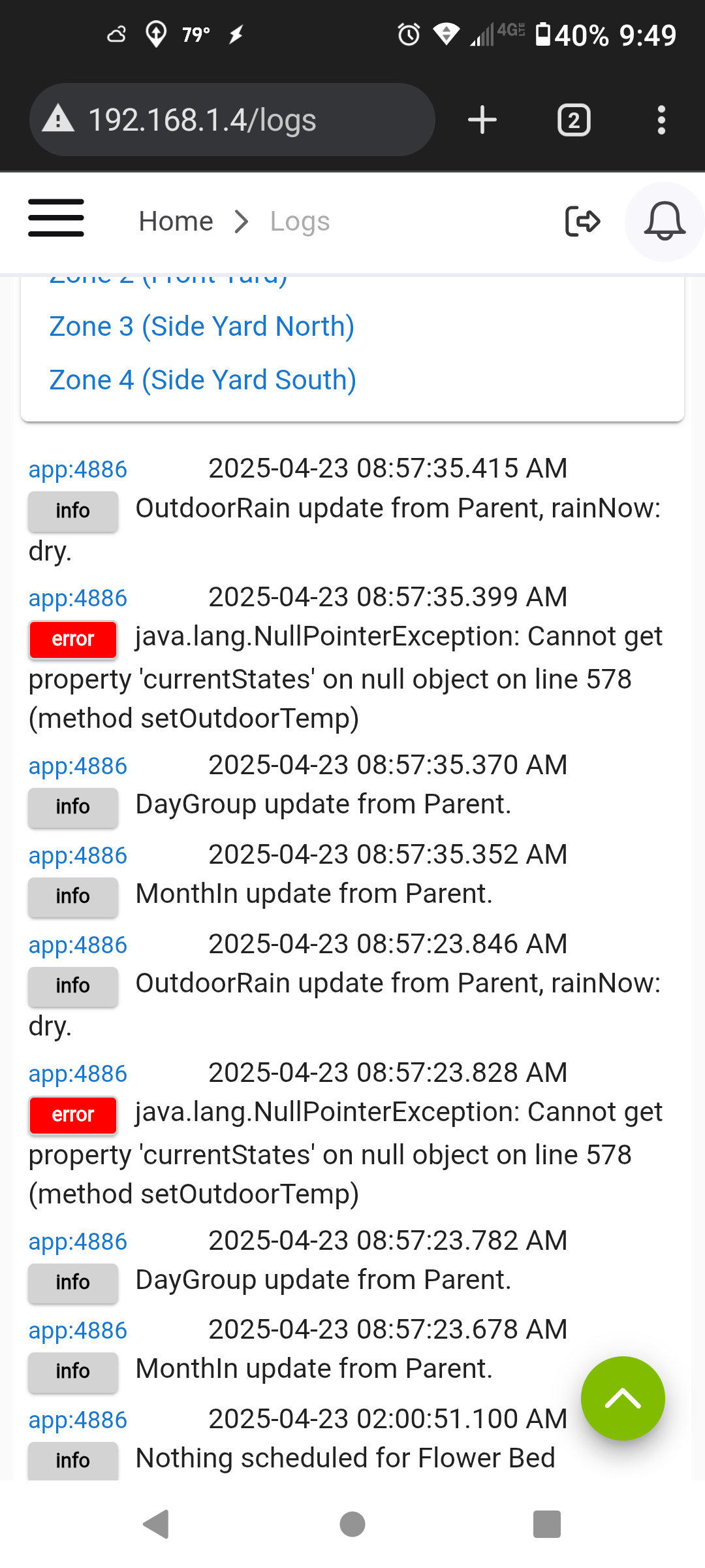

Here is another error for you to decipher. :grinning:
Here is the error:
I am not using temperature and here is my settings for temperature:

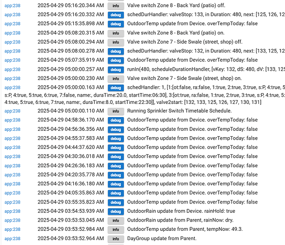

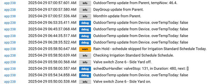

Here's my log from this morning. At 11pm, the child sprinkler schedule sets state.rainHold after being triggered by a change in the rain sensor (I'm using your hybrid virtual sensor and some Rule Machine logic to combine moisture sensors, a rain sensor and external delay).
At midnightish when rescheduler() runs, state.rainHold is reset to false, but the rain sensor is not checked again. So when the scheduler runs a few minutes later, it schedules the sprinklers, even though it shouldn't because the external 'rain sensor' is still set.
Is that the intended behavior?

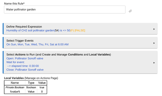

I gave this a try but I needed to be able to use moisture sensors for two different beds to enable/disable watering for the individual valves. One is for a raised bed drip system and the other is for a garden sprinkler. The Hybrid raincheck would need to be per valve. I didn't think about setting up two separate instances of Scheduler which if possible would have probably worked.

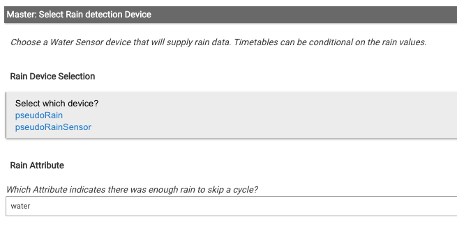

I've tackled adding additional Rain sensors to the Package. Lots of testing remains but here's a hint of the design I'm implementing:
First, in the Parent App, you select sensors, plural, if desired:
Just as today, selecting a rain sensor doesn't force any Timetable to USE it.
Within each Timetable, you can select ONE rain sensor, or none.

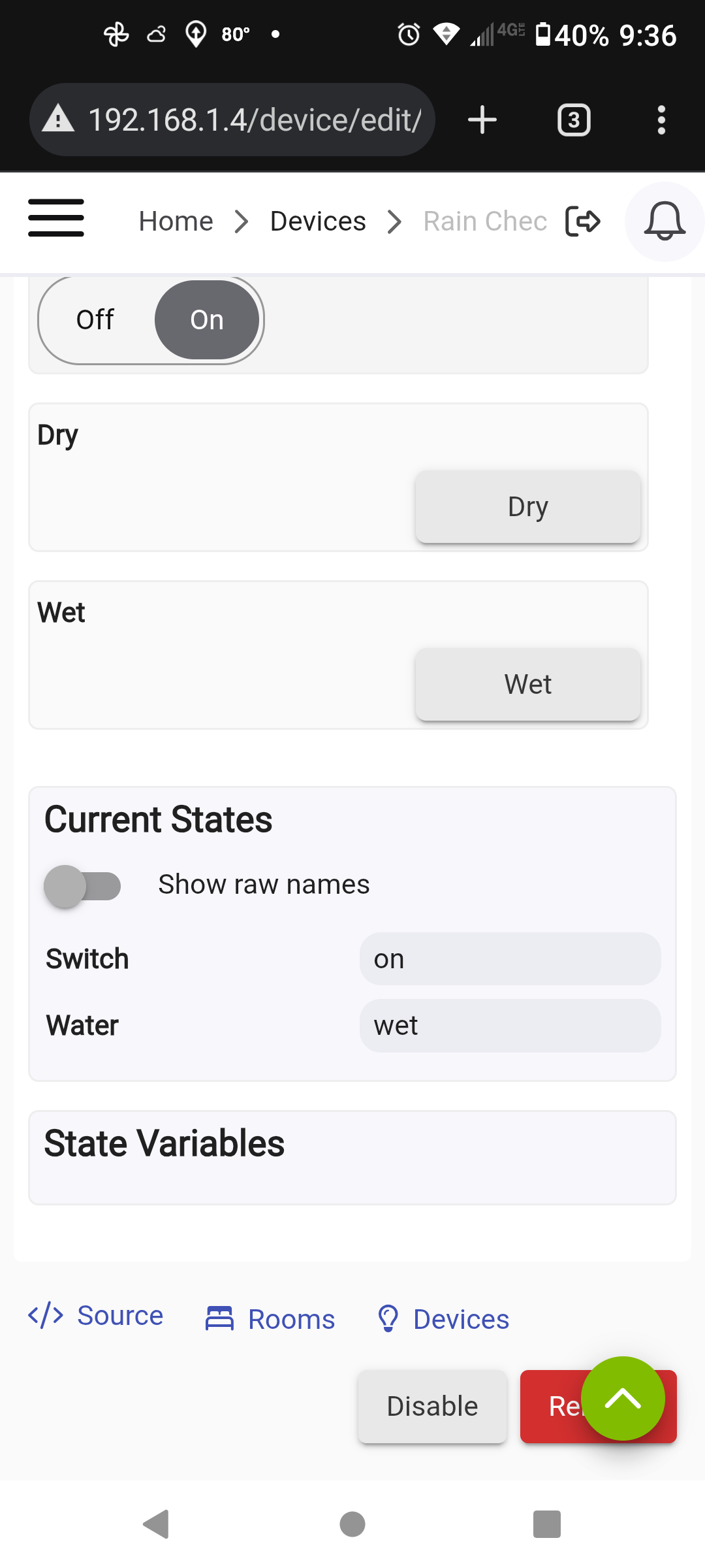

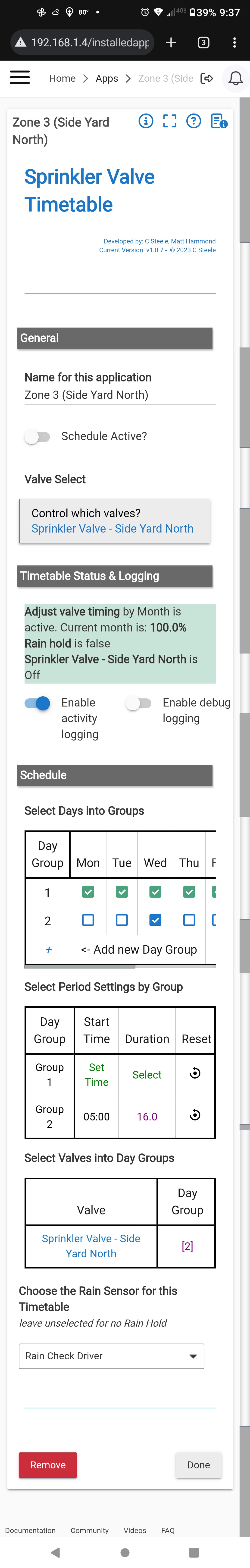

I think the latest release broke the rain delay.
I am using the rain check driver to manually hold the sprinklers. This was working yesterday. I updated to the latest version and now the rain hold is false even though the rain check driver is wet.
Take a look at your Logs.

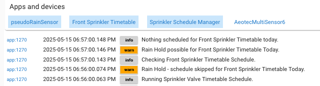

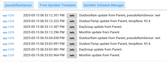

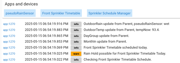

Screenshot 2025-05-15 at 6.53.36 PM
This first screen shot shows the selected devices and values being pulled over by clicking Done in any of the child apps.
It received an OutdoorTemp and an OutdoorRain update. The Rain sensor was wet.
THEN, I set a time a couple minutes in the future in the child and clicked Done again.
Screenshot 2025-05-15 at 6.54.39 PM
A check occurred, discovering that a rain hold was a possibility.
Finally, the schedule ran and aborted ("schedule skipped") due to rain hold:
Screenshot 2025-05-15 at 7.01.20 PM
I created a new schedule and it recognizes the rain delay. It's only affecting the existing zones.
I think I'll just recreate the 4 zones. There is some other garbage in them from the rain delay programming change. The current zones are still showing the NWS driver as an option then through it's been long deleted. By recreating everything will be fresh.
The change to add more Rain Sensors was more like a complete rewrite of that entire section. I didn't think it would be that disruptive but it was, in the end.
