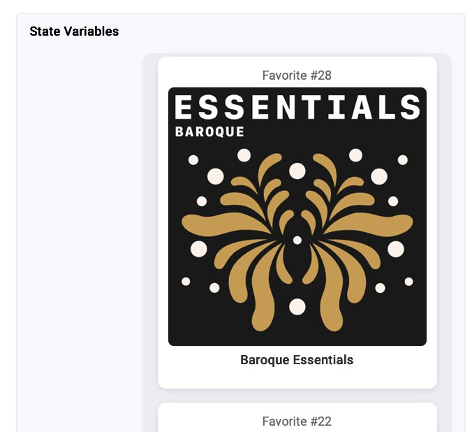

Added a minor change to the "Favorites" child device in 0.7.7. It now generates HTML with a bit of CSS and some other styling so it looks quite a bit better, and makes it much more clear which favorite number is associated with the images.
Example of new favorite on the Favorites child device:

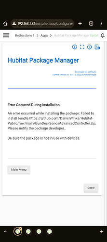

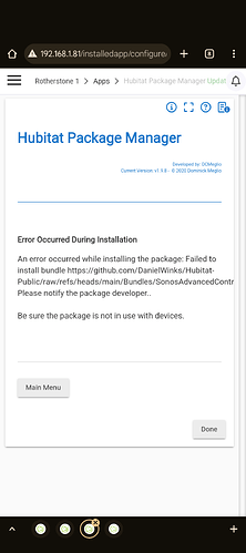

Seem to get a error updating through package manager?
Seems the link for the library isn't correct, I've updated it. It should work now on version 0.7.9.
Alright, I got a bit silly here, but the "Favorites" device not only looks a decent bit better, but it's also CLICKABLE... Total hack-job to get that to work, but you can click on a favorite and it'll do the same thing as if you used the "loadFavorite(<favorite number here>)" command on the parent speaker device. By default that should clear the queue and load that favorite.
Is that useful? Probably not, but hey, if you click a Favorite now it actually plays.
Same error?
Edit
Actually slightly different

P.S. I'm getting the same install error with 0.7.9
HPM’s getting tripped up on the same step for me too, still seems like an issue with the link to the bundle?
**Error Occurred During Installation**
An error occurred while installing the package: Failed to install bundle https://github.com/DanielWinks/Hubitat-Public/raw/refs/heads/main/Bundles/SonosAdvancedController.zip. Please notify the package developer.. Be sure the package is not in use with devices
